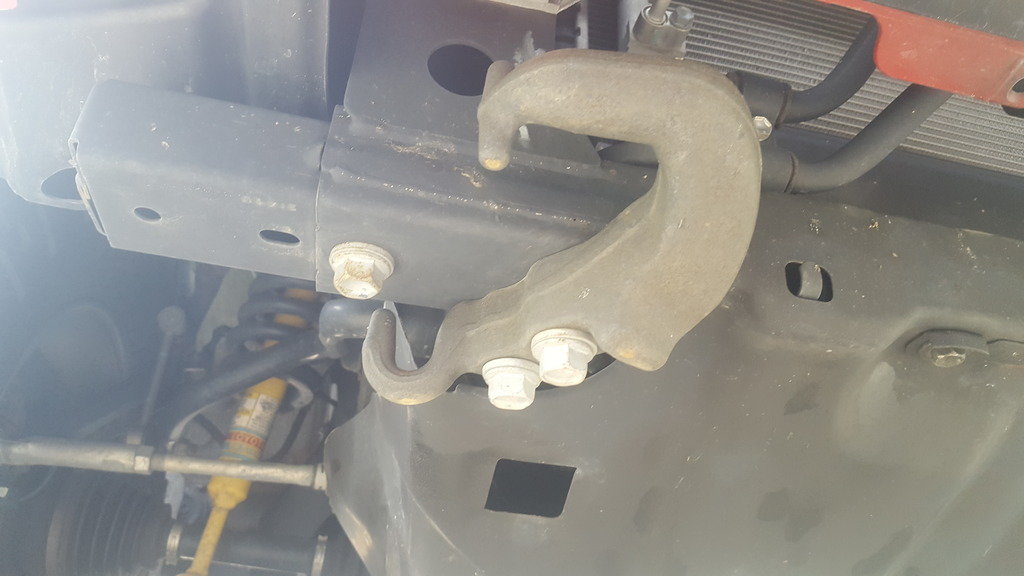

    super helpful thread all... thanks. Some context, then two more questions.
    I'm not really offroading - sadly more of a mall crawler. That said, friends ended up in ditches this winter due to snow conditions, and I thought having a tow strap setup would be a nice addition now that I own my first truck. From that kit I purchased, sounds like most are OK with the rear hitch mount setup. My questions are:
    1. for my uses per above, is that recovery strap ok, especially when used with the back hitch? Or is the concern more about pulling out of areas like ditches, vs. just ordinary towing on pavement.
    2. the BPF product looks like it connects to the exact same place as the existing recovery point - isn't that connected to the frame already? is the selling feature here thicker metal and stronger bolts?
    Sorry if these are idiot questions... appreciate the help.
    roguegs[OP] likes this.
  9. Apr 5, 2018 at 9:47 AM
    #69
    EatSleepTacos
    Mar 24, 2015
    #151688
    59,846
    Randy
    West Valley, AZ
    2017 4Runner
    1. The concern is more so the type of pull you need to do depending how stuck they are. Tow straps are great for towing along a disabled car on asphalt, as the name implies. The problem arises when someone is stuck, and they need a slight (or hard) tug to get them free. With a tow strap that isn’t a good idea because there’s no stretch. That energy gets transferred to both vehicle in a really harsh manner, and that’s how stuff breaks. If you’re just lightly pulling someone in a little snow then a tow strap works fine, but a snatch strap would also work just fine in that scenario.
    2. The benefit is more bolt points (3 vs 2), thicker steel, and the ability to connect a standard sized shackle to the front of the truck.
    Lemme know if you have any other questions.
