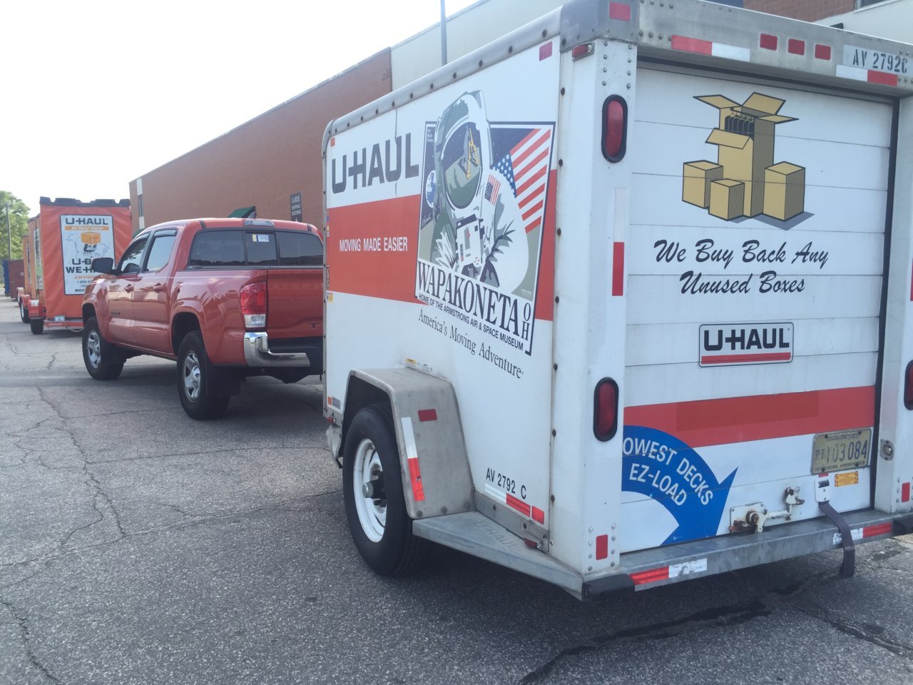

    I towed a uhaul from NC to Chicago last summer. Not a 16 footer, but can’t say I exactly obeyed the weight limit either. It was about 1000 miles with some pretty decent grades through the Appalachians too. I drove in sequential shift mode with ETC the entire time and ran through the gears like a manual. No problems here.

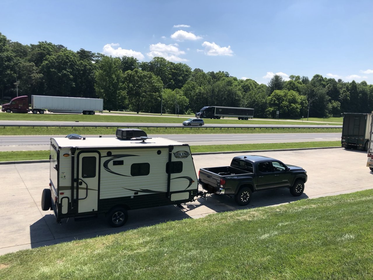

    Here is a photo of mine from a rest stop on Hwy 26 in NC. This was taken during the trip when I drove the whole time in “D” instead of sequential (like a dumb-dumb).

    What MPG did you get? Nice looking rig.

    I got 12.2mpg. Curious to see if it will be much different now that I know to tow in S mode.

    Bet it doesn't change much.

    12.2 sounds about right. What was your speed?

    Tried to keep it around 65mph.

    Man that's perfect. I can almost guarantee your truck stayed in 4th on it's own.

    Absolutely incorrect.
    It will not pull 6th at all unless on a decent and the same with 5th. You spend your time in 4th with it downshifting as nessecary. You are bang on regarding the wind resistance as it causes most of the load when towing regardless of the weight of the trailer.
    I have tested it in S4 as well as short tests with light loads in OD. Just use S4 and turn up the radio to cover the added noise from it rev’ing higher. Your fuel economy is non existent when towing so deal with it.
