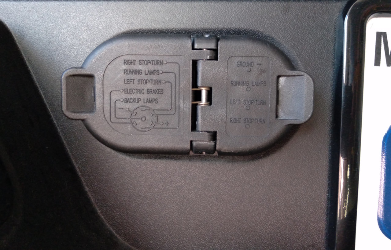

    Yup, I have '17. I have both plugs. No adapter needed. '16 and up have same setup as long as tow package is installed.

    My 2017 did okay towing a fully loaded 6x12 with no issues, they usually have the 4 pin connector so just take that in mind if you don’t have one. I also had 600lbs in the bed of my truck while towing. Pretty much drove it only about 55-60 in the slow lane hitting potholes all the way from Lake Havasu to Kingman. I averaged 10.5mpg which I thought I’d be getting… but yeah no issues.
