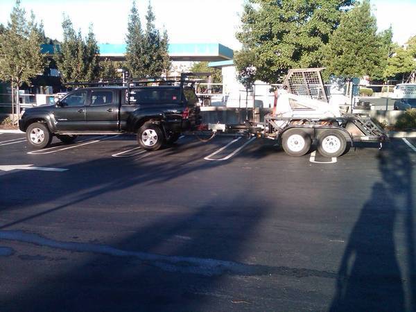

    I have a 05 4.0 v6 pre runner asking if the truck could handle a bobcat. The rental place told me the bobcat plus trailer weighs 8000lb. From my understanding the truck towing weigh is 6k. I havent towed anything more than 4k before. Just asking for advise.

    I've pulled a tractor on a trailer with about the same weight... Just make sure it's evenly spread on the trailer axles and take it slow. Remember, it's not what you can pull its what you can stop....

    I have pulled a lot of skid loaders in my life and even in a F350 without trailer breaks I was pushed through an intersection. I wouldn't want to do it with any Tacoma but properly working trailer brakes would be the most important feature. If you are a auto and don't have a trany cooler then forget about it. Either rent a smaller piece of equipment or get it delivered. Most of these places only charge $50 to pickup and $50 to drop off.
