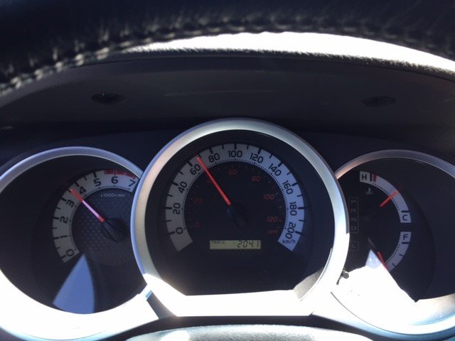

    This was going up Stevens Pass on Hwy 2 (Washington) on the way to Lake Wenatchee. Fully loaded. Towing a 19' Nash. Speedo is in km's, as in Canadian lol. It was slow. I wouldn't go bigger than a 22' travel trailer if your anywhere near mountains.
    Must haves are a good brake controller and equalizer bars.

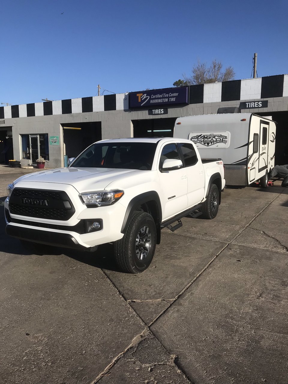

    Most of the "can I tow it" threads here are full of replies that leave me shaking my head from people that I assume have unrealistic expectations. Yes, the truck can tow it if you have the proper setup and run a WD hitch that is set up correctly. The bigger issue is the driver though.
    I tow a Jayco X213 that weighs 4,500lbs dry. Most of my trips are over 100 miles one direction and we take it out 6+ times a year. Our house is at 4,500 ft elevation and I regularly tow over passes between 6,200 and 8,000 ft.
    I often pass full sized trucks going up the grades and can hold 55mph (in 2nd). Transmission temps get a bit hot in the mountains so I installed a larger plate cooler in addition to the small factory aux cooler. You can't be afraid to make the truck work.

    Your WD hitch isn't adjusted properly. When it is all set your truck should be sitting close to where it does without the trailer hitched. Was it set up for your truck before toy installed the lift?
    If your looking for a trailer check out the Jayco X213 pictured above. King size bed slides out in the rear and there are twin bunks up front for the kids. Its a nice, small trailer for a family of 4 and you don't have to convert the dining area which is a big plus when camping with little ones that'll likely be going to bed before mom and dad.

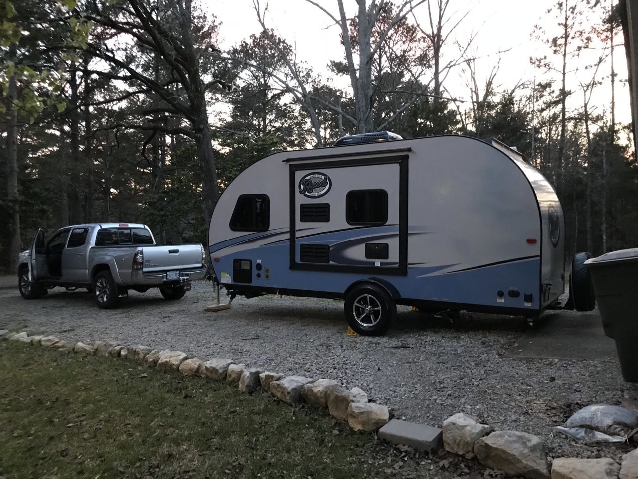

    My rig...2013 Tacoma Limited 4x4 with towing package, Timbrem Tortun4L Bumps, Anderson WD/Sway control hitch, pulling an Rpod 180, 2,700# dry, 3,700# wet (includes 2 passengers, full tank of fuel, etc.). Max hwy speed 65 limits wind resistance. No cruise control in hills limits number of downshifts , easier on tranny, improves fuel mileage. Was considering going to a Retro RV 23’, 3,700# dry weight but decided to stay with the lighter weight, more aerodynamic Rpod!!!! My Taco will last a lot longer.448181B9-B370-4BB6-BA30-230DAA20CA02.jpg
