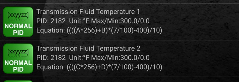

    Here are the equations from my 2010. I don't remember which is the pan and which isn't though.
    Trans 1
    ((((A*256)+B)*(7/100)-400)/10)
    Trans 2
    ((((C*256)+D)*(7/100)-400)/10)

    Ambient sounds were in the low 90s so definitely warm and a bit of a headwind didn't help either. Those are the same PIDs I have installed. On startup I'm running around 140ish and normal driving with low 90s ambient is around 180ish. Not sure about calibration, was under the impression it wasn't more or less plug and play. Appreciate the feedback guys.

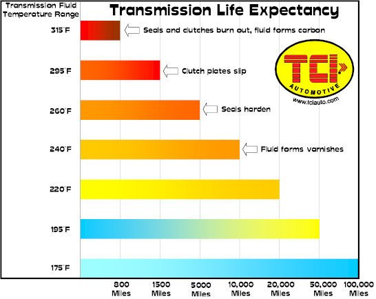

    upload_2017-6-25_15-14-1.jpgYou might want to look at this chart if your tranny temps are that high. You are already down to fluid changes at 10 to 20K.

    Not sure how accurate that chart is. Seems the internet is full of these that all report different temps.

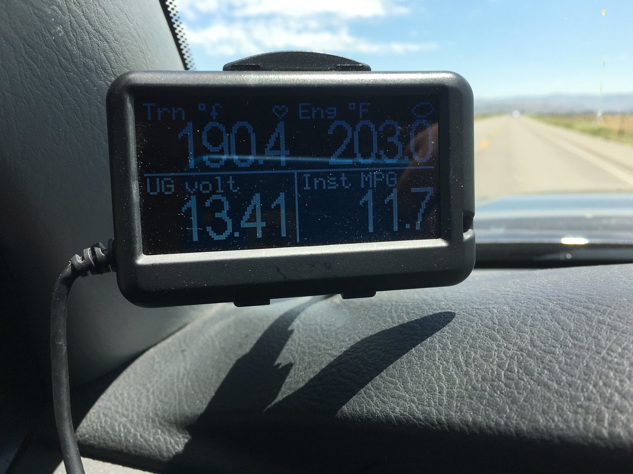

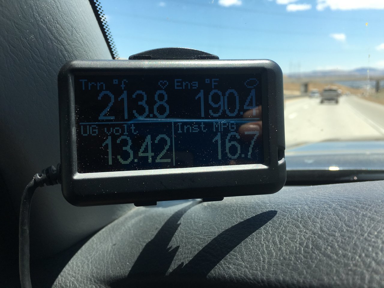

    @bcats4life, here's some comparisons for you. The first pic is after towing 5k lbs on flat ground at 60 mph for 25 minutes and the second is after going up a decent grade at 65mph. Temps peaked at 240f going over the pass but quickly dropped back down to 215f, where it remained for the rest of the trip home.

    I assume the chart is using Dino oil not synthetics? Synthetic oil would be about 25 degrees higher!

    The third gen thermostat doesn't open until 195F, so that chart doesn't apply to us. I assume that's also not for WS
