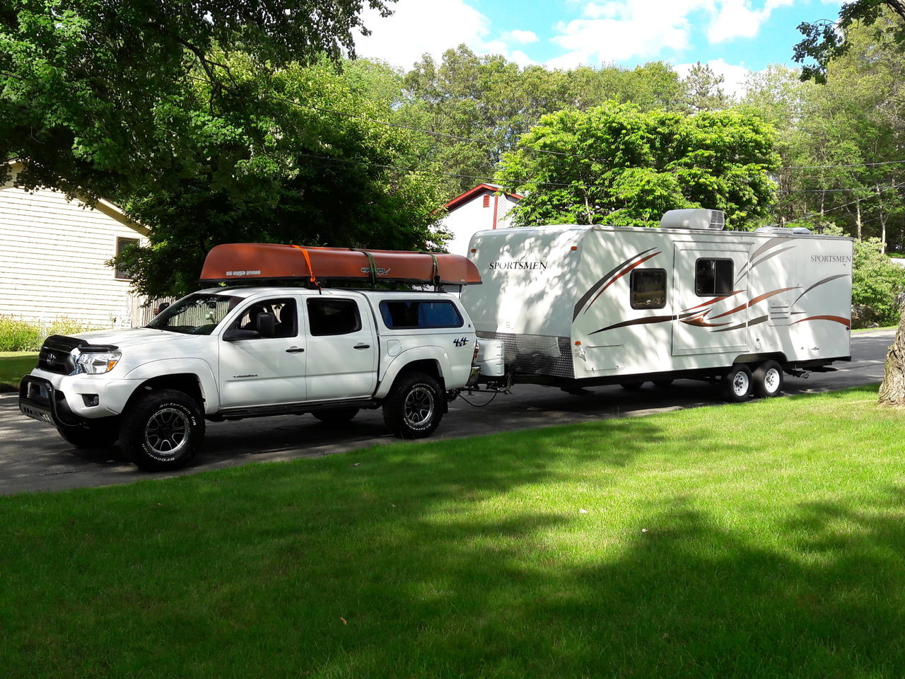

    I wouldn't mind chiming in on this. I have a 13 DCSB with lift, I tow a 26'TT dry it's 4350# and loaded for a trip it's 5300#+/-. My first tow with the TT using a scan gauge my trans temps were 260 pan 270 torque, outside temp 90* some hills. I only towed the TT once after I seen these tempts. I then installed a larger Trans cooler, took a trip that weekend, 90* outside temp, bigger hills, trip was up to new York / Canada from Rhode Island (long as trip) and my trans temps came way down to the highest points of 210* pan and 223* torque. So installing a larger cooler will make a big difference

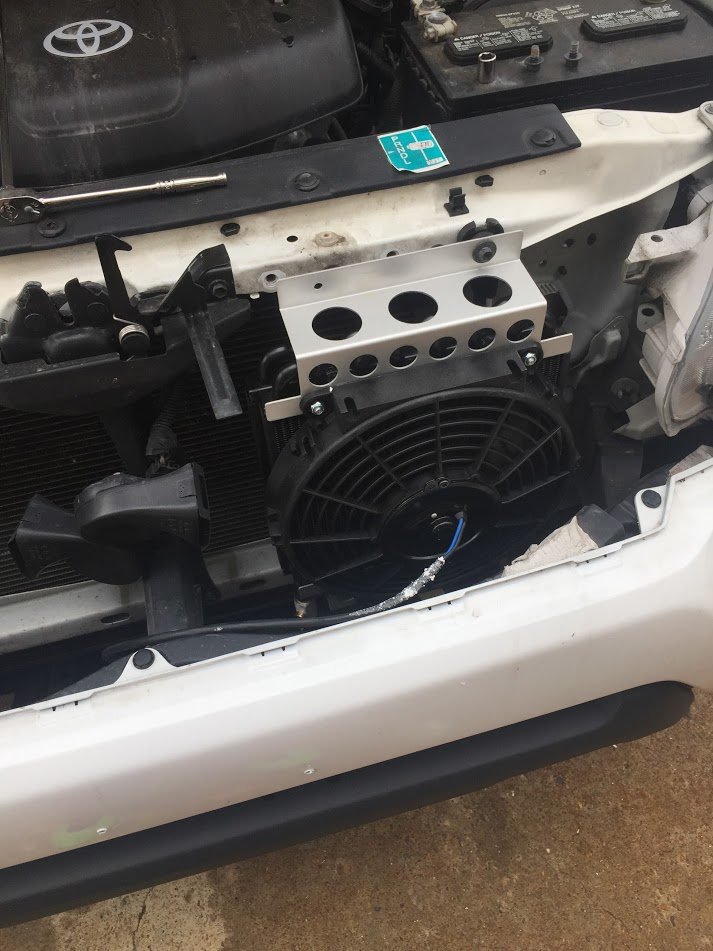

    if you add a second one, take a look at the ones with fans. Mine comes on at 200ish, its a double row cooler. havent had a chance to two with the fan hooked up yet or the new gauge, but it seems fine now. will test it again soon.

    you should ditch those pipe-and-fin coolers and get one real one.

    for this application, and the cost, it works quite fine. maybe next time. towing 6k it didnt seem to have any issues keeping the trans cool.

    Are two of those less than 50 dollars?

    its a combo kit, "used" from Amazon for 47 bucks i believe.
