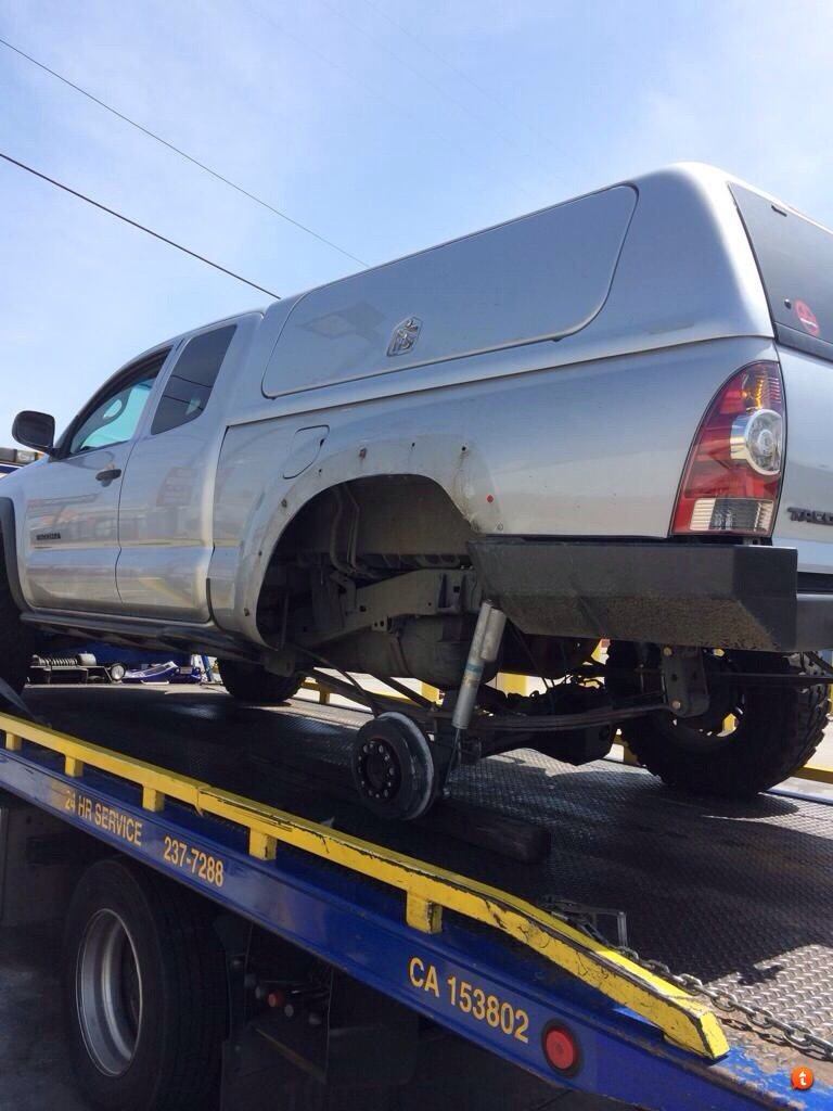

    I wouldnt man. Another dude on here had a wheel break off due to spidertrax. I wouldn't wanna be towing something heavy and wake up dead the next morning because my wheels fell off with almost 2 tons dragging behind me on fully functional wheels lol

    Sarcasm.. Just tryin to save lives. Wouldn't want my kids to get killed by a stray airborne tire either

    Who's wheel broke off due to a spidertrax?

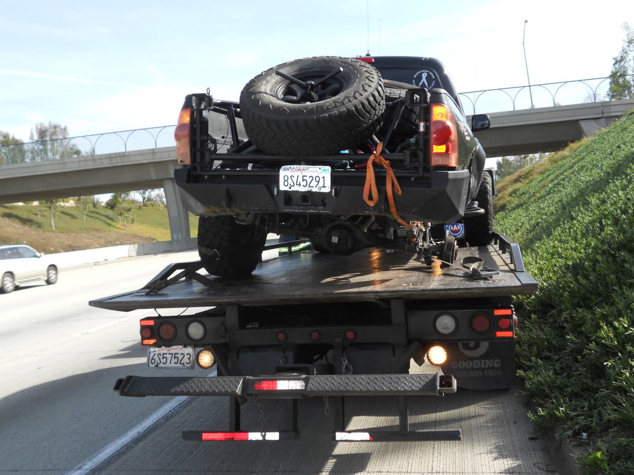

    I'll try to find the link. I saw some pictures on here the other day of a guy who it happened too. Theres also this guy, who had no pics:

    Spacer studs sheared off when he was going down the interstate.

    because they were over torqued , says so right in the post you linked , same thing can happen to the regular wheel studs

    Due to improper torque most likely. If they are not properly installed they can snap off just like if you install your wheels with improper torque. There is noting wrong with properly installed wheel spacers and SpiderTrax are one of the best on the market.

    Doesn't matter. He said it was done at a toyota dealership, so you never know when they are at risk for failure.

    The same can be said for your wheels that has nothing to do with spacers. Lugs are lugs and if they are over torqued they can fail.

    I'm not buying the assertion that wheels are just as likely to break off while in motion as a wheel spacer

    Same thing happened to me. There were no spacers in the rear, just over torqued and fatigued from the many many many times I have my wheels on and off..
