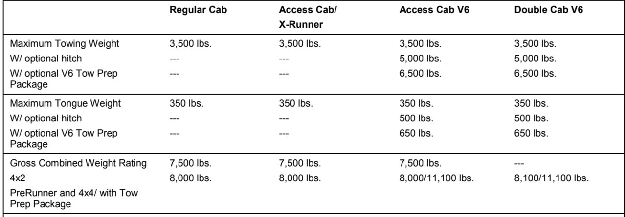

    I have the second gen 4cyl 5 speed. It's rated at 3500lbs, the 6 cylinder is the same unless hitch and or towing package came with it. Below are factory specs for 2009. The 3500lb limit is probably if you are using a ball on the bumper.

    Most of them are rated for 6500 lbs with the tow package, 3500 without it. But the most important part of the tow package is a transmission cooler. Since you have a manual you don't need a transmission cooler. I'd not be afraid of 3500 lbs or even a little more even without the tow package. I wouldn't try to tow over 4500 lbs even with the tow package. There are a lot of reasons and it gets complicated, but virtually none of the 1/2 ton and mid size trucks can actually tow what they are rated for. Once you get to 3/4 tons most, (but not all) will.
