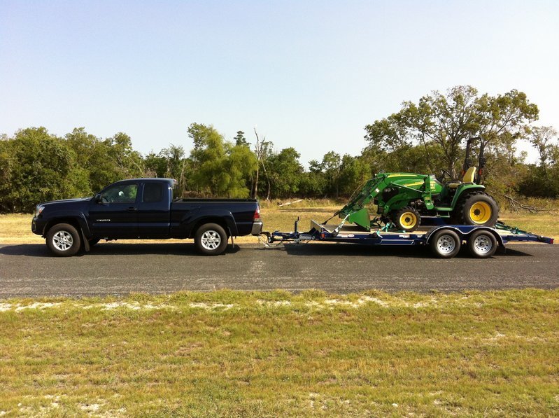

    Dec 11, 2012
    #92904

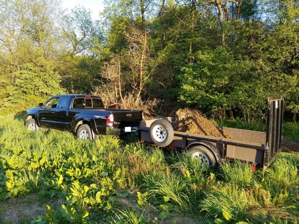

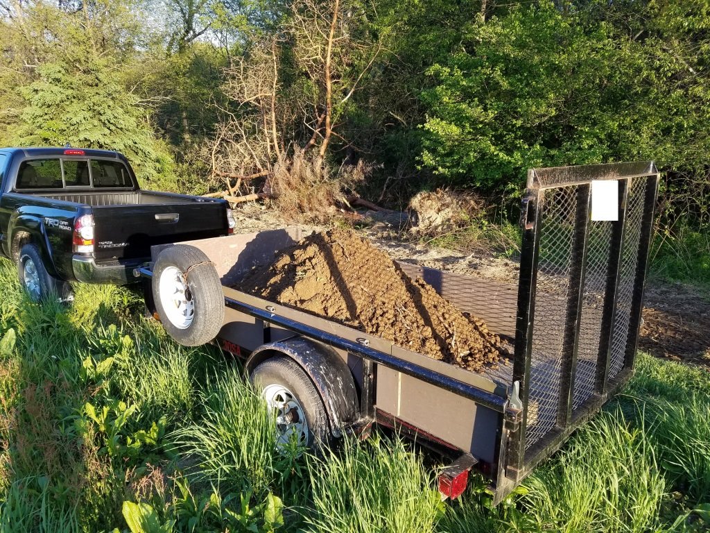

    I borrow a friend's homemade trailer a lot and the axle is mounted much too far back. Basically any load on that trailer will be in front of the axle. Normally I'm only hauling a quad, so it's not that bad, but it's a heavy trailer and certainly makes a difference. I've hauled a small lawn tractor on it as well.
    Borrowed a different trailer recently to haul a small lawn tractor a few times and tonight I hauled a load of topsoil when I returned it to the owner. The lawn tractor I had all the way to the front of the trailer just because I thought I could secure it best there. The topsoil I had mostly just ahead of and over the axle. In both cases I did feel like the front end was a little light. It wasn't a problem and the truck handled fine for the most part, but I was also really babying it.
    I'll need to borrow that same trailer again in 2-3 weeks to haul a lawn tractor again. Next time I'll try centering it over the axle and see what kind of difference that makes.

    Here's a couple of pics of the topsoil from tonight. As you can see, it's not much. But like I said, maybe I should have loaded it back a little more.

    You are towing the wrong color tractor! :)
    Your truck will tow this load just fine. Here's a pic of my '13 towing the right color tractor. :)
    It's a Deere 3520 that weighs approx. 3800lbs with the loader.
    Be sure to use a weight distribution hitch. rkd has good advice in post #7. The position of the tractor on the trailer will determine the tongue weight.
    Enjoy.
