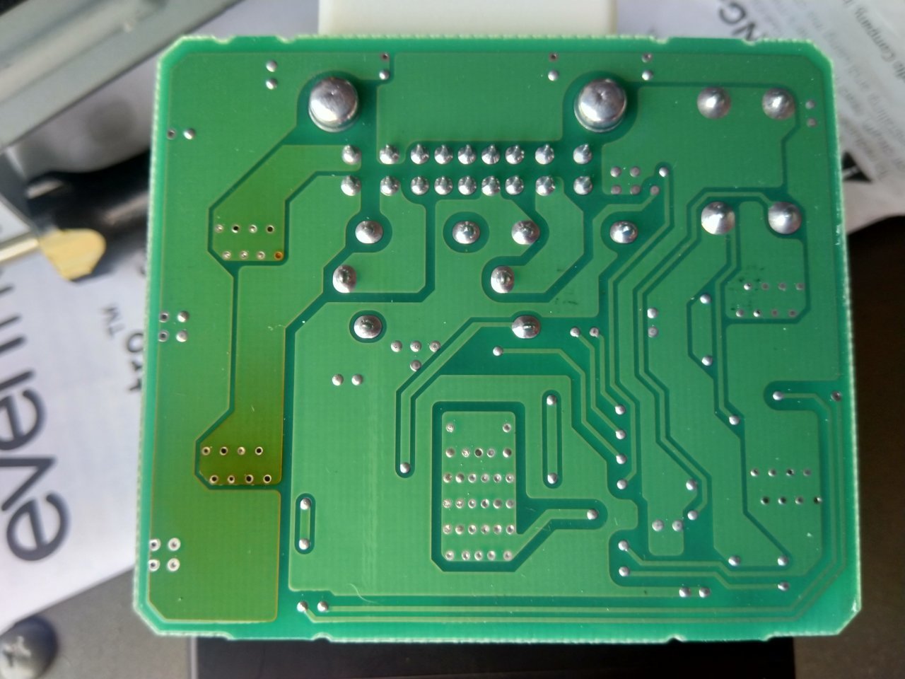

    OP, would you upload a pic of the bottom side of the burnt board?
  11. Nov 21, 2020 at 2:42 PM
    #31
    projectmoonlite
    projectmoonlite [OP] Taco noob
    Jul 6, 2018
    #258524
    82
    Texas
    2012 Truck
    As for now I went back to factory setting just to make sure I've 100% fixed the issue. I'll tinker with it again in a month or so with the non-DRL relays.
  12. Nov 21, 2020 at 2:42 PM
    #32
    projectmoonlite
    Jul 6, 2018
    #258524
    82
    Texas
    2012 Truck

  14. Nov 21, 2020 at 2:50 PM
    #34
    nd4spdbh
    nd4spdbh Well-Known Member
    Oct 7, 2013
    #114055
    14,583
    SoCal
    13 DCSB TRD OR v6 Auto
    hard to put the blue smoke back into electronics. Yeah that will do it!

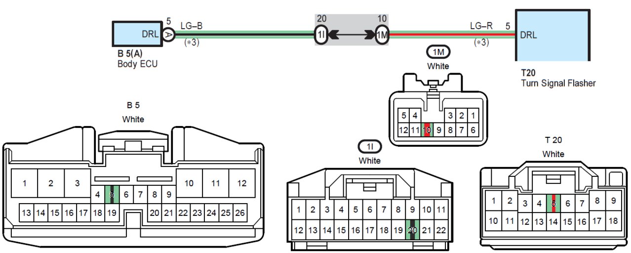

    Yeah that makes sense because the tail light works as normal. Studying your post taught me that actually. I've been studying this post by you for the past two hours: https://www.tacomaworld.com/threads...ow-turn-with-drl-relay-on-a-2011-2005.643600/
    It seems to me that if I were able to get a female connector for the Smart Tap, maybe by cutting one off a scrapyard BECU, I could modify my stock harness and get everything working. Plug 1L back in, send turn signal combo switch inputs to both the smart tap and the DTRL Relay, then de-pin T20 turn signal lamps and put them on the smart tap instead. Keep the trailer lights connected to T20/DTRL relay so it's really just controlling the trailer lights, stop and turn feature.. I think it would work but not sure which power and ground the OEM Relay would still need, or if anything bad would happen from it only controlling the trailer lights. Obviously the smart tap features wouldn't work on the trailer but I could care less for the three times a year I tow, no brake lights or turn signals on the trailer is a real problem obviously. If you could help with which wires the OEM Relay would need for just controlling the trailer lights I would be eternally grateful.

    See post #12. Ask if it's still confusing.
    P.S. it is not showing the front/drl and mirror turn signals.
