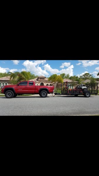

    Screenshot_20170408-081415.jpg I tow a 2,600 pound trailer and it's completely stock and leval, the secret is to have you're hitch at the right height to leval out the trailer, and distribute the weight on the trailer over the axle..
    rtzx9r, 1bad2k and bigfoote13 like this.

    This. Weight goes over the trailer axle. And I would expect some sag if you are putting a lot of weight onto the trailer, especially the front. We do not have F350 suspensions and should not expect our trucks to haul those types of loads either.
    Ledfoot 26[QUOTED] likes this.
