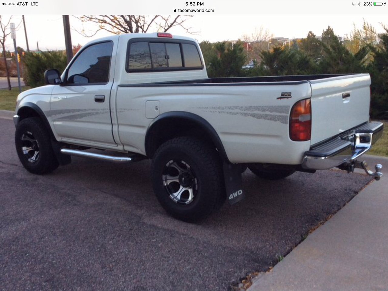

    Useing a hidden hitch IV with a brake controller in the cab and a
    Stainless steel receiver so the 2 parts will not rust together
