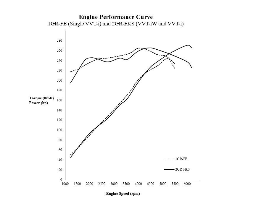

    Here you can see the wave that was one of OVTune's primary objectives with regards to the tune. The 4 liter is lower, but flatter. And weirdly makes slightly more hp up to about 4250 RPM. The drop off is steep for the 4 liter at high RPM though and is why I always chuckle when someone asks about towing with the 3.5.

    Once rolling 2nd cannot keep up with 3rd. Power is just not there. Never try to pass a 3rd gen unless they let you.
    That gain the 2nd has off the line is gone as 3rd catches up quickly. That equates to much faster passing times than the 4.0 which just bogs down.
