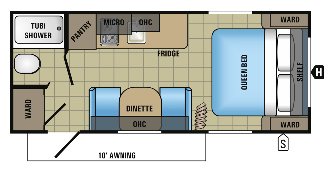

    This Is what I pull. 2800lbs dry and allot of trailer in a little space. Down side it's not kid/family friendly setup .

    Looks very similar to what we're looking at, but we'll be getting a floor plan that includes bunk beds for the kids. [​IMG]

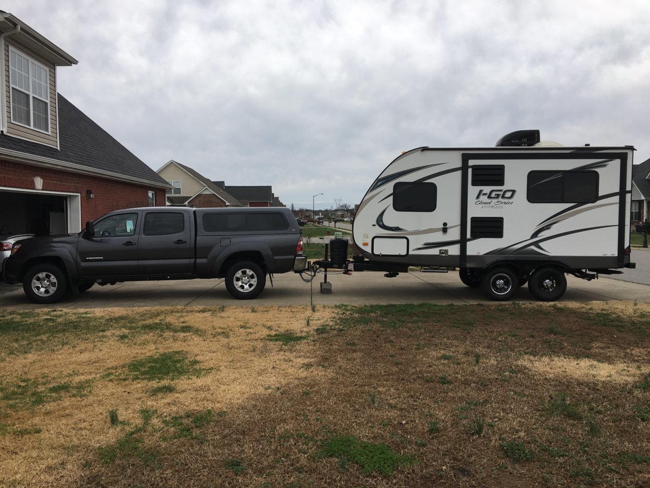

    I have the tow package, but handle this fine. 4880 dry weight.
    1_original_outlaw likes this.

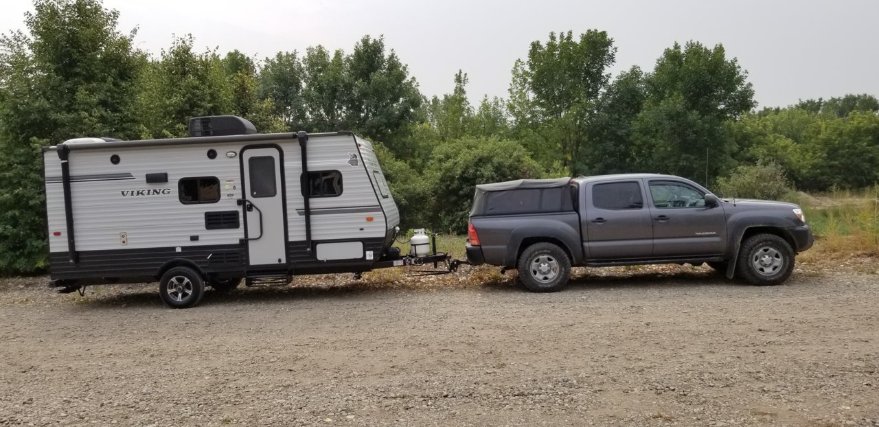

    We ended up getting a new trailer. It's a 17bh, no slide out. It weighs around 2900 dry. Happy so far, but we'll have to wait until next spring before we can start getting regular use out of it.

    2020 Tundra SX
    Looking at your setup the only concern I have is that it looks like you don't have a sway controller. The WD hitch with the chains won't give you much sway control.
