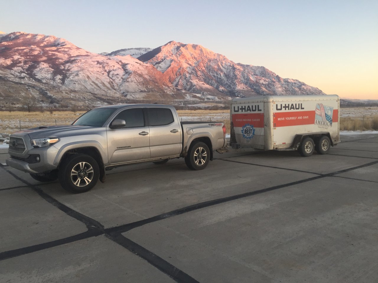

    7F1C0559-A63C-41F4-A8D9-C46D67C22DF6.jpg I own a ‘17 TRD Sport with tow package and just moved from Miramar Beach FL to Salt Lake City Utah. Traveled 2100 miles through Texas and the. Up through New Mexico, Colorado and into Utah going from sea level to over 7,500 elevation through passes, some of which were snow and ice packed.
    Thought I would share some lessons learned. Trailer and vehicle weight loaded was 8900 lbs at the weigh in scale, the trailer empty was 1,900 which puts about 4,000 pulling throughout the trip with the rest of my gear in the vehicle and bed (have a g2 backflip cover).
    I was able to maintain 5th gear throughout most of the trip through FL, AL, MS, LA, and TX. As soon as I started to go north through NM if you wanted to stay above 60mph you will be in 4th at almost any incline.
    I stayed in 2wd until Albuquerque when the snow storms packed the roads with ice and loose snow. There were moments when I was in 2nd and tapping brakes and in 4hi to keep the momentum going through passes but as long as you drive smartly the Tacoma did surprisingly well. I’m from Montana and lived in Alaska and have driven on bad roads my whole life, and there were a couple stretches on the highways that were pretty bad, yet the Tacoma tracked well and was predictable even when pulling the trailer. There was a spot between Gallup and Albuquerque on I-40 where several vehicles were off the road did to hazardous conditions, but as long as I kept it slow the Tacoma remained predictable.
    I averaged 15mpg in 5th at 55-60’ and 12-13mpg above that. I parked several nights on snow and ice parking lots and got snowed on twice overnight, and the Tacoma pulled right out both times.
    I’ve towed before but never for this lengthy of a time or spanning across this much distance and elevation in some sporty conditions and hope it helps those who are considering doing the same. Hit me up if you have any questions.

    That's great fuel economy. I got less than 10mpg in my first trip with the new trailer.

    The weight isn't the biggest factor for fuel economy at highway speed, aerodynamics plays a bigger role. The uhaul trailer is more aerodynamic than your trailer.

    I wouldn't say his rectangle on wheels is any more aerodynamic than my rectangle on wheels. What might contribute to higher fuel economy (beside next gen truck) is that the uhual trailer looks significantly shorter, so you don't have as much drag above the roof line with that trailer compared to my travel trailer. The lower your rectangle on wheels, the less drag, and the better your fuel econom, y. When I used to pull my tent trailer, I got virtually the same fuel economy while pulling it, as without.

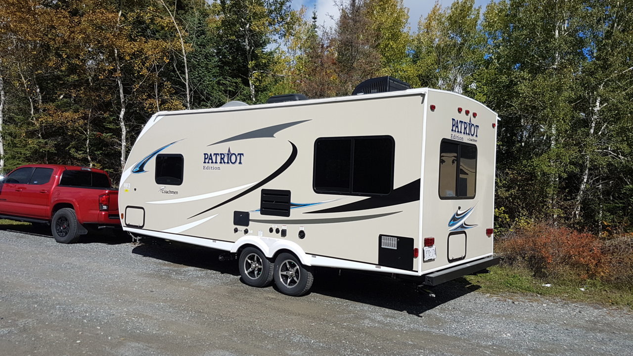

    Where do you plan to go camping? How many people, animals and gear in the truck? I'm towing a Coachman 204RD that comes in at 4,000lbs. With my wife, me and a small dog we are ok and under the payload when the trailer is attached. My trailer comes in at just under 5,000lbs loaded and a full tank of water and I don't have any issues.
