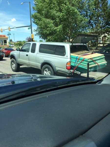

  16. Jun 23, 2015 at 8:32 AM
    #16
    NineFingers
    NineFingers Member
    Mar 16, 2015
    #151052
    12
    Dave
    Colorado
    Speaking of full loads... I saw this the other day... I don't think it'll ever ride the same again, LOL.
    alexo09[OP] likes this.

    I did similar things with my '99 when I had it (usually a yard of wet manure) and it never bothered it. I had an AAl in the rear, but the leaves always sprang back once the load was off of them. They never looked 'kinked' like the leaves in my 2nd Gen do when under a load, either.
    On the other hand, when it was freighted down you'd step on the gas and the truck would just say 'Huh? Oh....right..... Give me a minute'
