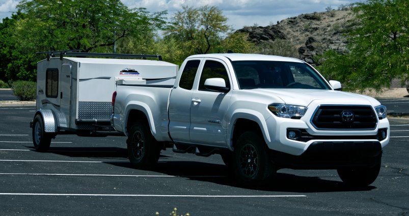

    2023 V6 SR5. Picked the trailer up about 500 miles from home. Have a wdh. Trip home was no big issues but a few observations...
    MPG was worse than I expected - about 9 MPG. We were going about 60-65 and it was reasonably flat (Green Bay to St. Louis). We rented a _slightly_ lighter trailer that was fiberglass and more rounded and streamlined a couple months ago and the towing was noticeably better in terms of mileage (about 12) and smoothness of ride. Before I put more tension on the wdh it was porpoising moderately on the roads with concrete joints. With more tension it was better but still a little. And the ride without the trailer for some local trips seemed rougher so it was at least partly due to rough roads.
    Had just a bit of impact from passing big rigs. Nothing concerning but a very slight pull. I think I could tighten the wdh some more but didn't want to get to carried away and risk a bent frame on driveway entrances and other uneven places.
    Was pretty reserved on the throttle but still noticed I ended up downshifting (3rd? How do you tell what gear it's in?)on not that steep of hills. I have read about hunting and some place recommend OTT tune. One option is to shift manually on hills I suppose.
    I did read just a bit on transmission cooler being dropped a few years ago. Need to read some more and will likely get a scan gauge. Might get a cooler. Does the TC lock in all gears and just work for shifting?
    Some people other places have already told me I need a bigger truck. That's not unexpected but I don't want a bigger truck although I might consider something similar size with larger engine.
    Not related to towing but the radar in cruise slows down for vehicles ahead WAY before I thought it was needed. It would slow down before I expected it and then speed up when I changed lanes.
