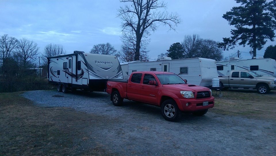

    For the past couple years, I have been researching the possibility of towing an RV with my '06 Prerunner. The opinions run anywhere from it being a suicide mission, to "sure it'll pull a 40' gooseneck". I travel for work and am kind of tired of living in cheap hotels. So I finally decided to bite the bullet. I purchased a Keystone Passport 2510. 4880 dry weight. I added universal mirrors, break controller and the trailer came with a weight distribution hitch. My Prerunner has 197k miles, so I figured if it wouldn't tow it I was due for an upgrade if needed. I just towed the RV back from Atlanta GA, home to middle TX (about 900 miles). No issues to report, 70-75 MPH on the interstate. Hills lugged it a little, but that was expected. I also just did a short trip to Colorado Bend State Park, just outside Lampasas TX. Loaded with gear and fresh water. Some winding roads and steeper grades, the Taco handled it just fine. I'm sure I will upgrade at some point, but for now the Mighty Taco is holding its own.

    Hey, first of all congrats on the Passport, you shouldn't have any issues with your PreRunner. But wanted to share
    Pair 05-14 Tacoma Pickup Towing Mirror(L+R) w/ Textured Black Cap/Manual Extend. These are the mirrors I've added to my '07 4dr SR6 longbed for towing my bullet. That was after having 2 sets of the mirror fall off on various trips. They work great and fit perfect and yes they are made for the Tacoma not the Tundra. Hope this helps?

    That is good to hear and congrats! Did you get a chance to weigh the trailer (loaded)? Or have an idea of how much weight you added to it?

    Dry weight 4880 per trailer specs, 200 lbs water?, another 300 lbs gear, 2 bikes clothes food pots pans plates. The hitch is a heavy chunk of metal itself. I would say I was around 5400 +-. I did not drive over scales, but that will be close if the dry weight on the spec sheet is true.

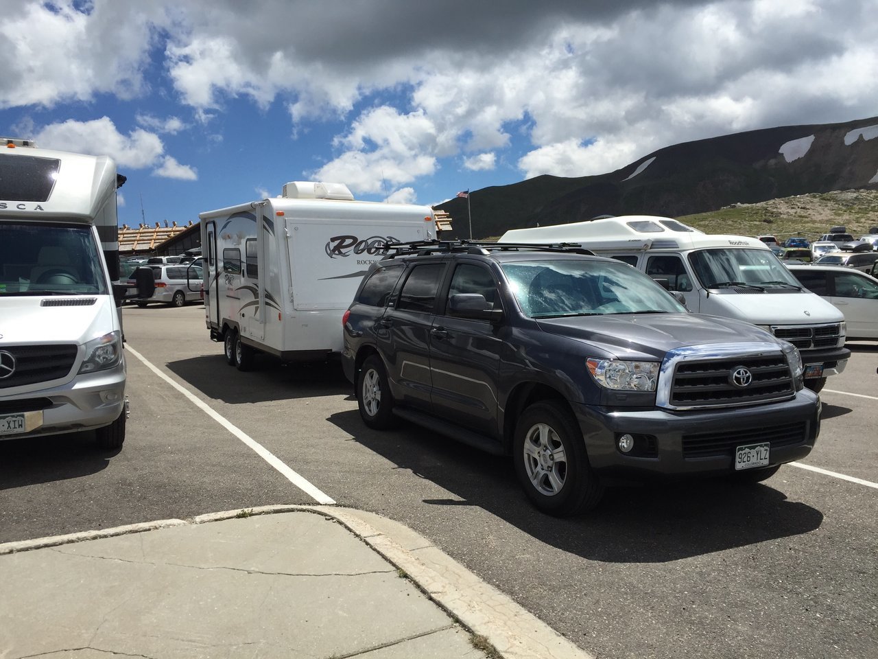

    I’m in Colorado and went with the land yacht for my 6000 lb load. I think the new Tacoma could do it but for me I wanted cushion and uphill power. We love the camper but if I had fewer kids I’d get an off-road trailer that you can add an RTT to the top then add the Tacoma and you can go anywhere!565B03C7-12FB-4605-8D7A-56637689F59B.jpg
