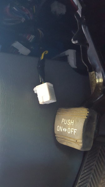

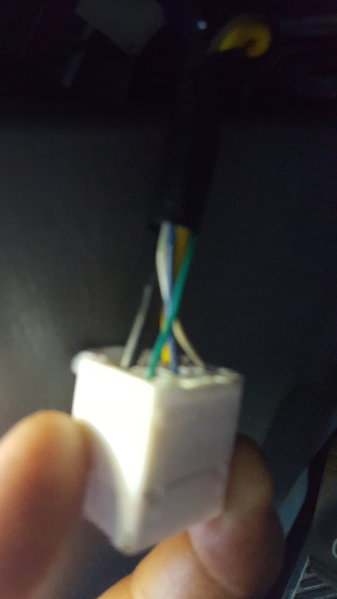

    Craigslist happened and I totally forgot to upload these, anyways its the only plug thats not connected to something, look to the left of the parking brake.
