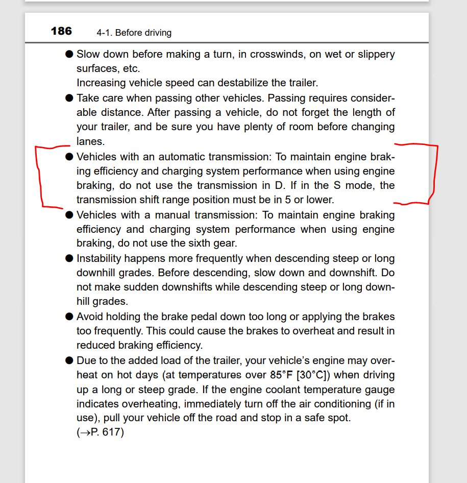

    I have had no issues following the instructions in the manual when towing my boat. :boink:

    The manual advises to tow in S mode with 6th gear locked out. I’ve found personally that I have to lock out 5th as well for a good tow experience and the lowest trans temps that I can get. Also, I get to select the correct gear for engine braking or going up hills and not leave it up to the AI to decide. In 4th gear at hwy speed I’m turning 2600~2900 rpm. Could do that all day long. It just feels good. :)

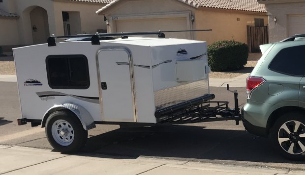

    What say a small camper around 1000 lbs, 200 lbs in truck bed, 300 lbs in cab -
    Any need to go into S mode or will standard Drive be fine... pulling hills... Arizona heat.
    Subaru 4 cylinder handled it fine.
