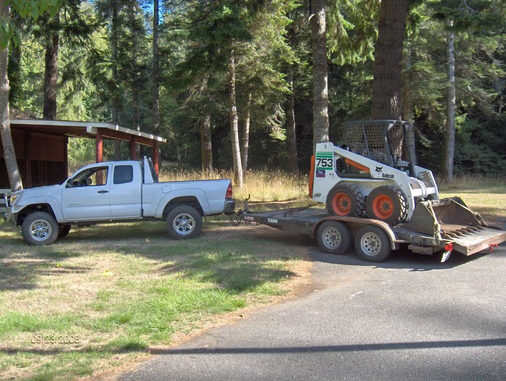

    I'd do it, just remember to take it easy on hills and in traffic. Acceleration and braking is limited a lot with that much weight on the hitch.
    My old truck:
    4740lb skid loader + trailer. Handled it great.
