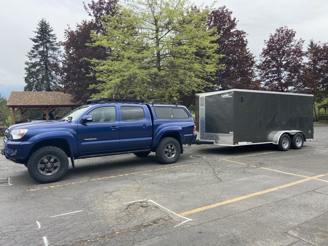

    I found a “new in box” set on Craigslist for $250 I think maybe 4 yrs ago? It seems like one of those parts people buy and don’t install. Just be mindful of where you run the air lines, I helped someone fix crushed lines on a motor home because of that. But they work well, easy installation.8F2AA19A-3CB4-4924-8AA9-85877ED0C879.jpg0BF56BD8-FDB6-4CFA-9399-21437CB704A1.jpg
