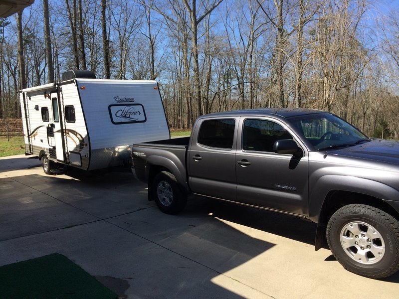

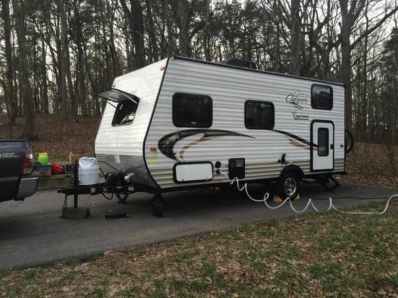

    Here's the camper. Not huge or anything, but we have to drive in the mountains from time to time.

    just under 6500 lbs. running 315/70/17 MTs. stock gearing. you I spend a lot more time in 3rd and 4th gear, but it tows well. just have to realize that it will drive very differently in all regards. been towing this boat since the truck was brand new (8 years), and never had a problem.
