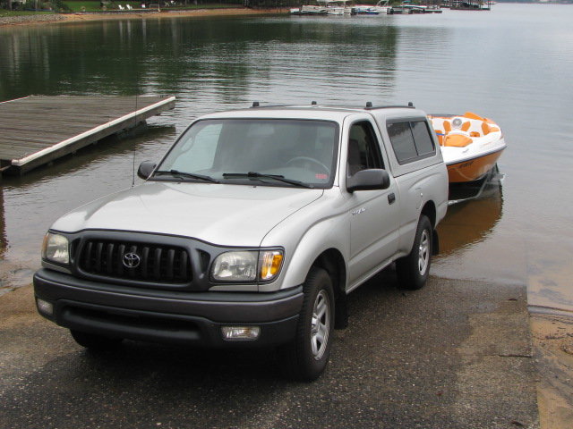

    Update, finally purchased a boat/trailer rig and very happy with how the Tacoma tows it. Decided to go with a lighter boat/trailer rig than mentioned earlier. Got a 155HP Sea Doo Speedster 150 that probably weighs in around 2000 lbs wet with trailer/gear. The Tacoma tows the heavier Sea Doo rig easier than the 1600lb TT because of the additional wind resistance of the TT.
    Towed the Sea Doo 700 miles earlier this week from New York to North Carolina. The Tacoma got 20MPG at an average speed of 65MPH on interstates.

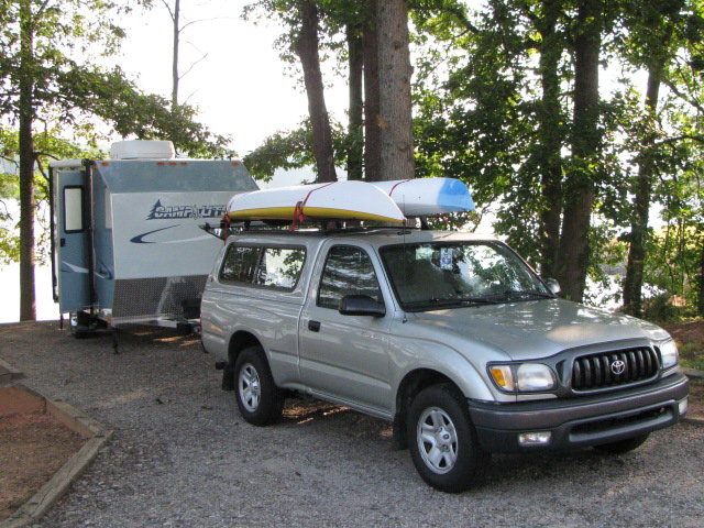

    Don't tow the camper over 60MPH and cannot shift to 5th unless going down hill. Mount two Kayaks on the pickup shell in hopes of reducing the wind resistance of the camper, plus we like to Kayak anyway :)! That might be helping, but can't really get much use of 5th gear towing the camper @ 55 to 60MPH @ 17MPG. When towing the boat can cruise in 5th @ 65MPH easily @ 20MPG.

    Like the looks of the CampLite truck campers. Do you have a photo of your rig?
    Just got back from a camping trip in the NC foothills with the Taco/CampLite rig and very pleased with the Taco's performance in the foothills during the last couple days. A friend followed in his late model V-8 powered Nissan Titan towing a 3500lb camper, and he thought the Taco performed well, too! :)

    How does it do pulling the boat up the ramp?
  14. Sep 18, 2012 at 12:06 PM
    exploringcarolina
    exploringcarolina [OP] Well-Known Member
    Jul 6, 2011
    #59392
    152
    Bill
    North Carolina
    2003 Tacoma
    Nice looking rig!!!!!!!!!!!!!!
    No problems pulling the 2000lb boat/rig out of the water on a paved ramp. Have not tried it on a dirt/gravel ramp, yet.
