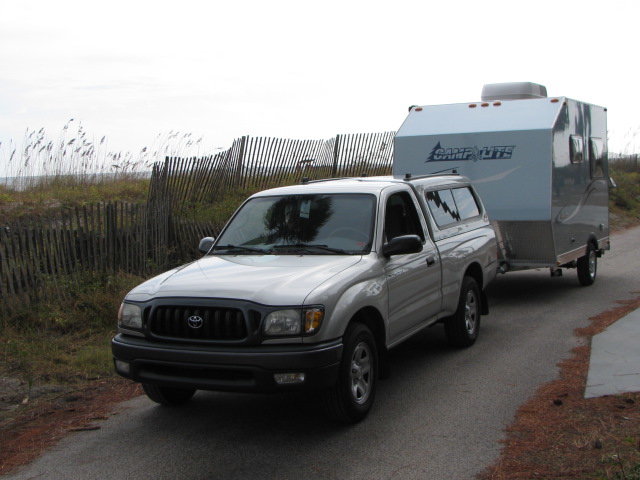

    Ours has a 11' long box with queen size bed/dinette & couch that folds out into a single bed. It's a basic camper and we call it our Aluminum tent with heating and cooling. :)

    Have not had it weighed, but the manufacturer says the CL11RD weighs 1400lbs dry. We carry about 200lbs of stuff in the camper and another 400lbs of coolers, Kayaks, fire wood, gear & food in the back of the pickup. I estimate the Camper @ 1600lbs plus 400lbs in the back of the pickup for a total of 2000lbs load.

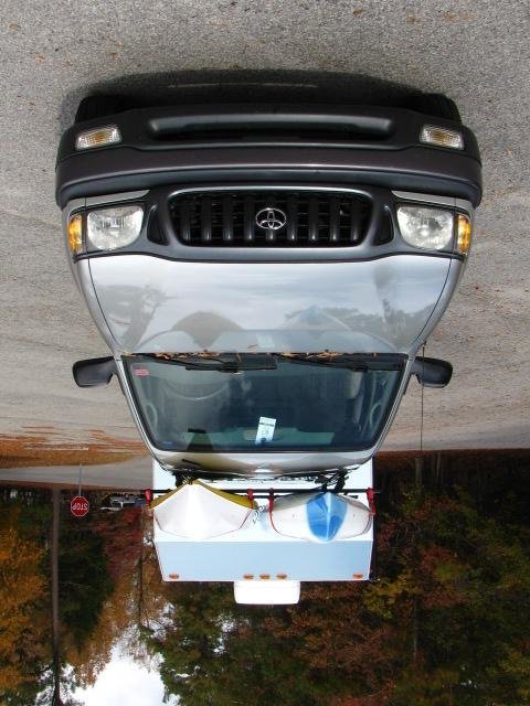

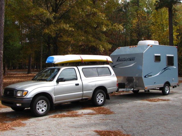

    Been testing fuel economy towing the CampLite camper on interstates in 4th gear @ 2500RPM in central and eastern SC with and without Kayaks mounted on Thule Racks. Hauling estimated 1900lbs with camper/camping gear/Leer Shell, and 2000lbs with Kayaks/Thule Racks added to the load.
    Previous test 550 mile round trip to Hunting Island SC with mileage checked on interstates averaging 55MPH "without" Kayaks. Mileage was 17MPG.
    Just got back from a 200 mile round trip to Lake Wateree SC "with" Kayaks getting 18MPG averaging 55MPH on interstates.
    Kayaks must reduce wind resistance and Taco feels like it has more power on the hills @ 55MPH. Testing results from ScanGaugeE. Taco is stock except for mods in signature.

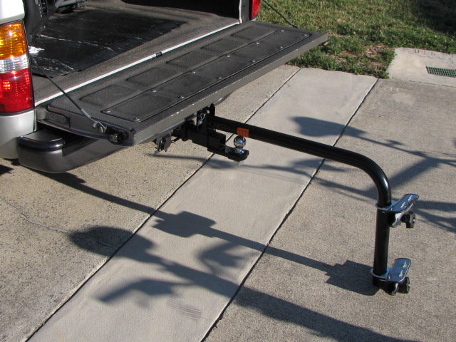

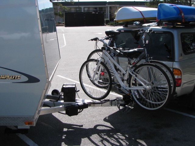

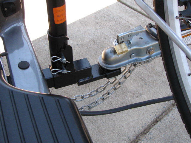

    Learned a couple things last week. Wanted to take bicycles with kayaks camping. With a 2"X4" aluminum rear bumper on the camper, did not want to hang two bikes & rack on the camper bumper and did not want to put the bikes on top of the pickup shell increasing wind resistance. Found an extended hitch I could mount a Swagman XP bike rack on between the camper & pickup. It worked out nicely.
    Before I had been hauling the camper with a 3/4" rise hitch. This bike rack set up worked with a 2" drop hitch, letting the front of the camper ride a little lower. Found I could use 5th gear on level & slight uphill grades @ 60MPH average @ 16MPG. Before when using the 3/4" lift hitch, I could not tow the camper up any grade, without going to 4th gear on interstates. All I can figure by lowering the front of the camper slightly, gives "less" wind resistance.
