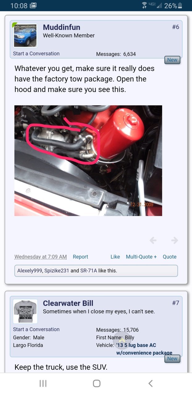

    I have a manual and was wondering why there is this then?

    side note, what does that little doohickey do, is it is a radiator fluid cooler? I am inclined to think those are coolant lines routed into that sandwich block to help regulate coolant temps in comparison to oil temps?

    The red thing is your oil filter and the unit and hoses are your oil cooler

    I get the oil filter...however the lines running into the sandwich block, are filled with coolant, yes? Oil generally operates at lower temps than coolant in my limited mechanical knowledge.

    Engine oil temps for normal stuff can be 230-260 degrees. Severe or heavy duty situations can push oil temps to 300.

    My fusion pro app says engine oil temp stays around 185*. Where that sensor is located, in the pan or the oil filter mount, I don't know. I speculate that the coolant cooling the oil is coming from the exit (cold side) of the radiator and the temp sensor is in the oil filter/cooler mount. I'm third gen tho.
