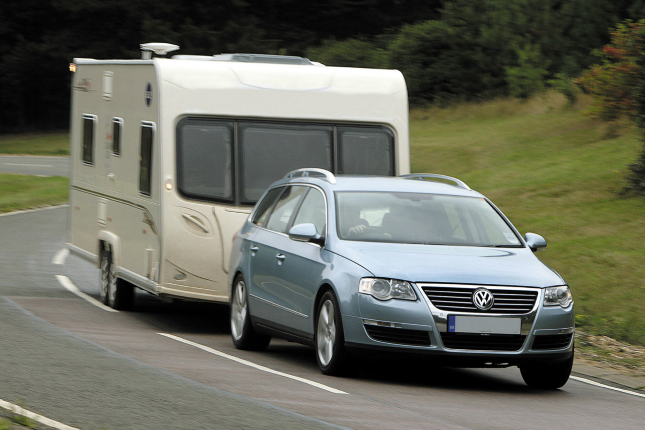

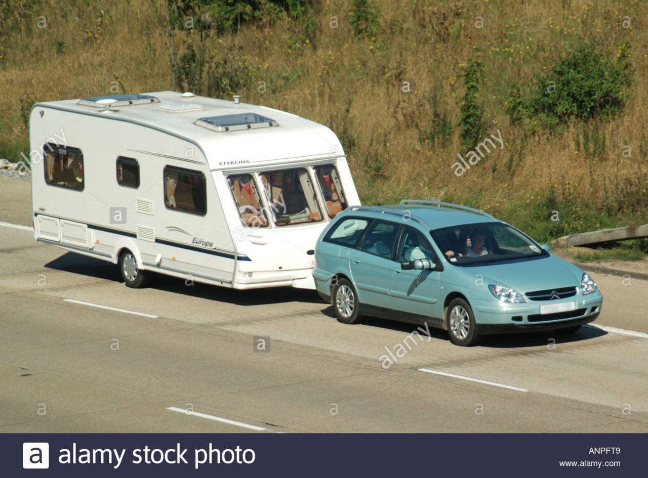

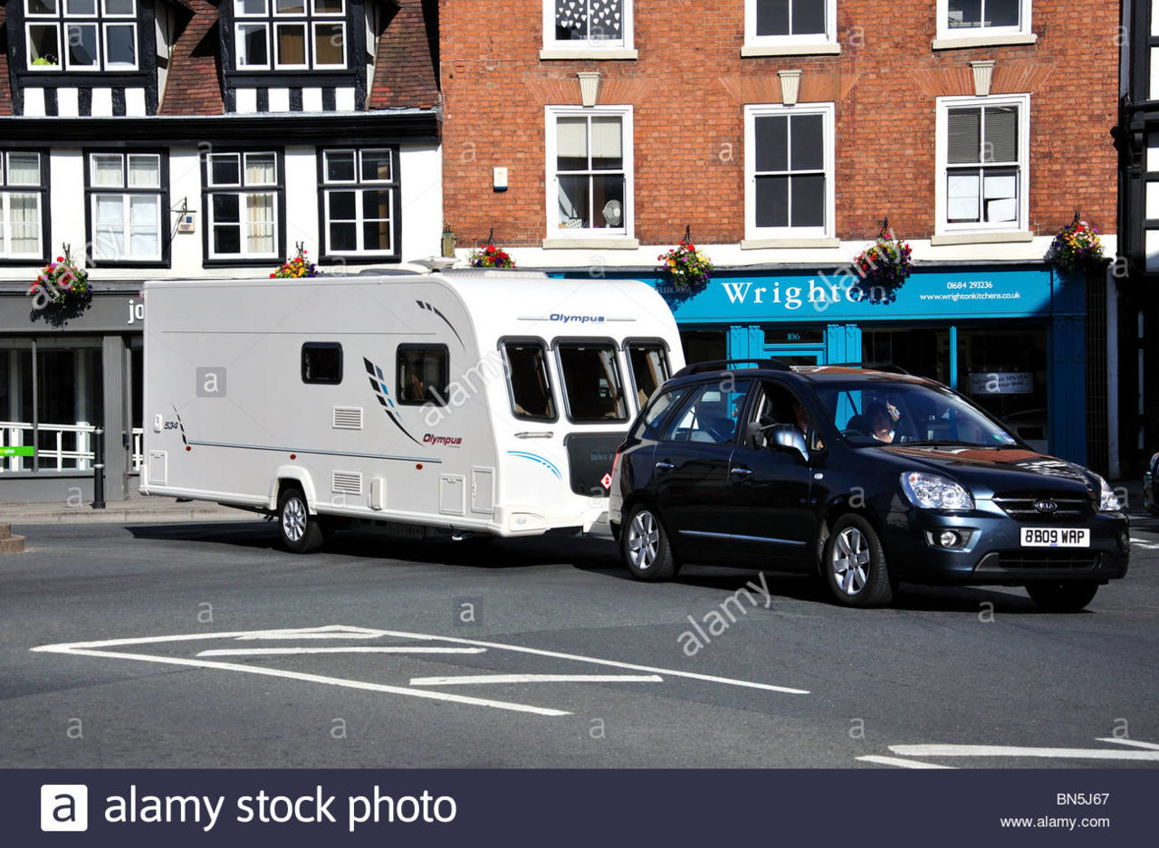

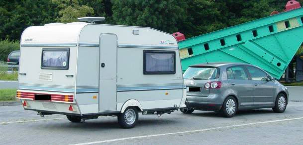

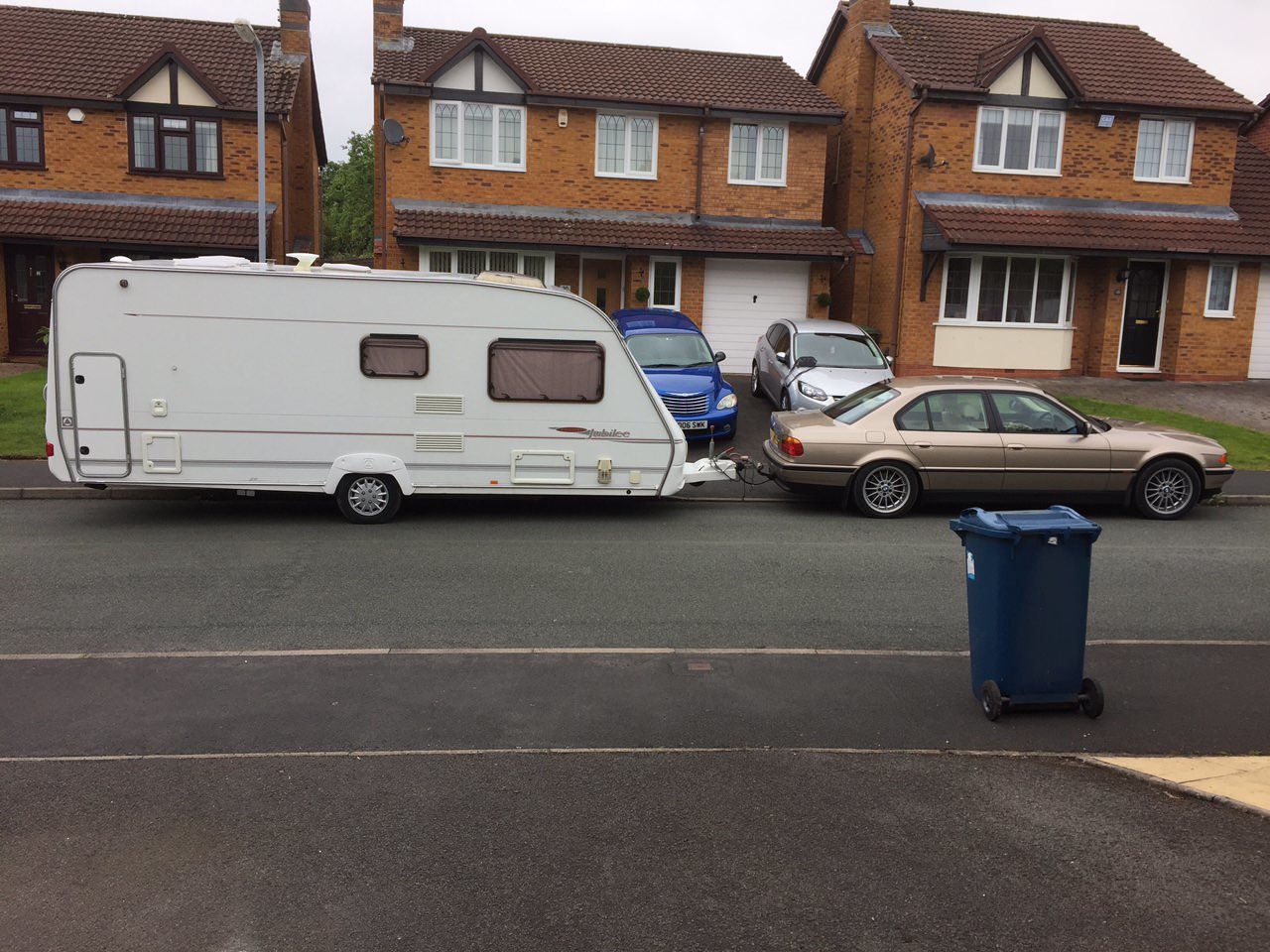

    On another note, Americans would lose their minds if they saw what the Europeans tow, and what they tow them with. Horse and travel trailers with economy cars. They have speed ratings, and they have to designate which vehicle is towing what trailer, have them inspected, and then they are given a Max speed rating like 50km 90km 120km.
    Here's some examples of people towing in Europe. You can't go 20 miles in the area I'm in without seeing them.

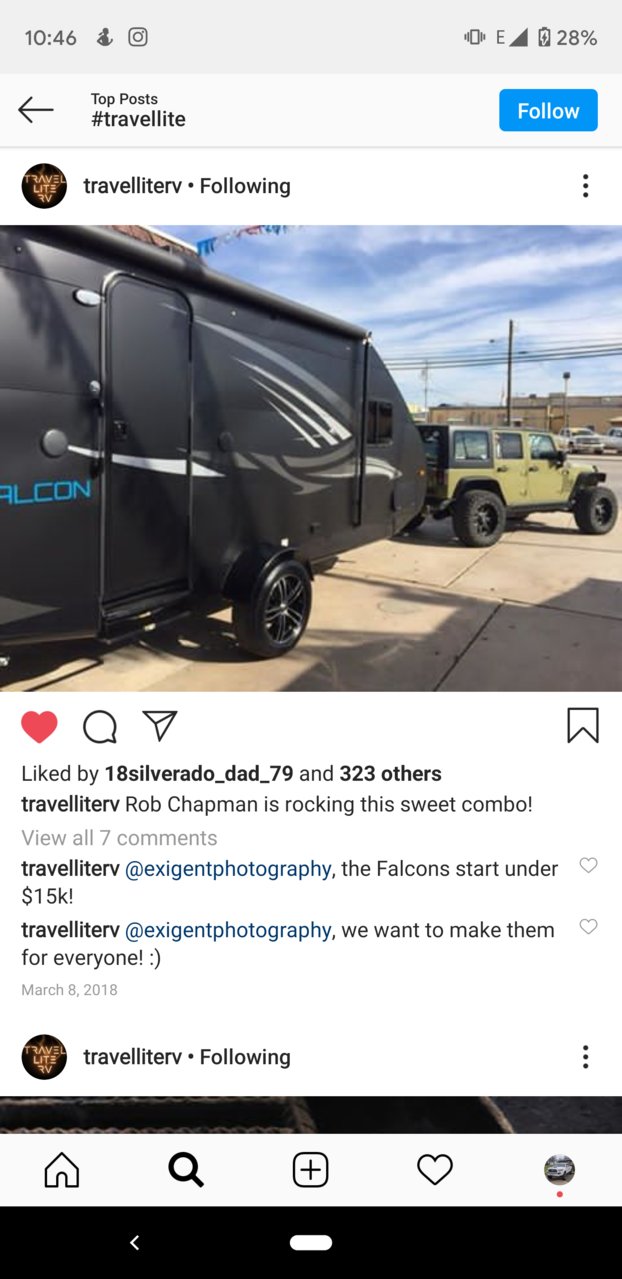

    Great points. I will be doing all of that, I currently am running icon NXT leaf pack and am deciding if I should do sumo bumps, air bags, or put the overload spring back in.
    Also, I found someone pulling the shorter Travel Lite Falcon on Instagram. Seems like they love it. I am going to shoot them a message.
    Check this one out too, if a Jeep Wrangler can pull it, I can too. Cracks me up how many people own them and tow them with a Jeep. The max tow capacity is 3500#, or at least it was on my old JKU. Although, from my understanding that is because it is looked at as a convertible, and that is the max tow for any convertible.

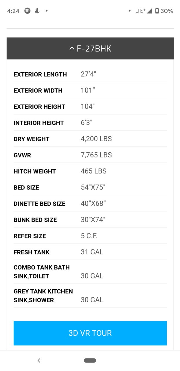

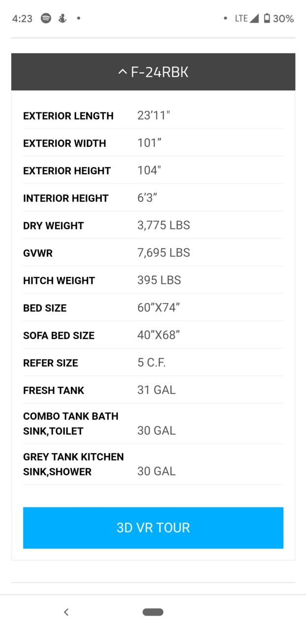

    Also, sorry I threw out two model names without any references. I'm thinking my best options are the Travel Lite trailers, due to them being designed to be towed by my truck (smaller v6 vehicles). I've also decided these two models fit my requirements best, and I think they are both within my limits. Links are below.
    https://www.rvtrader.com/Travel-Lit...model=Falcon F-24BH|764971317&trim=24BH|50204
    https://www.rvt.com/Travel-Lite-Aura-27BHK-2019-Akron-OH-ID9172713-UX54814
    The 27BHK I think is about maxing out my Tacoma.
    I've also attached images of full specs (tongue weight, dry weight, etc.)
    Is it true that with gear and fluids you can generally add roughly 1500 pounds to dry weight? That gives you a rough loaded/fueled/full water/tow weight?

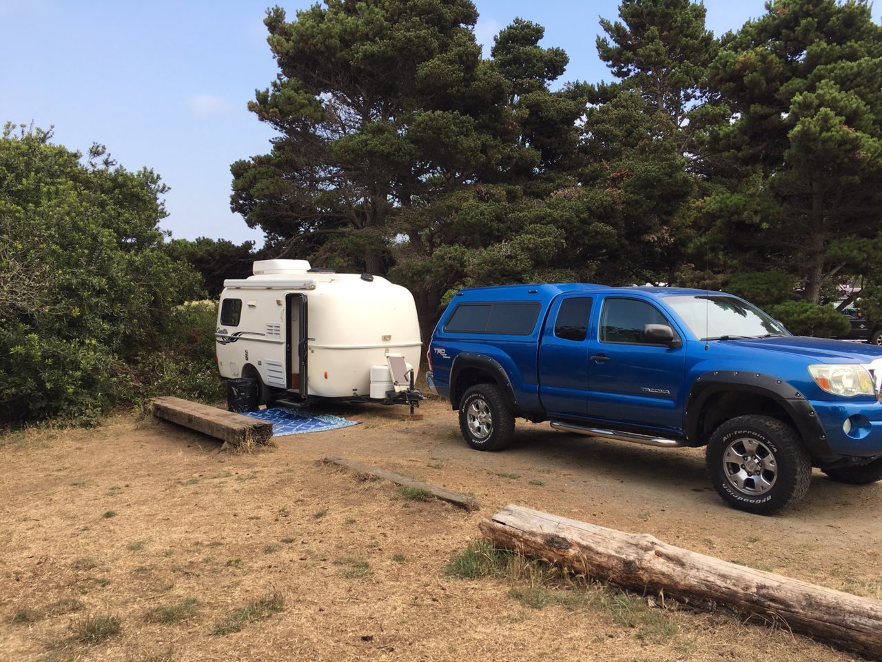

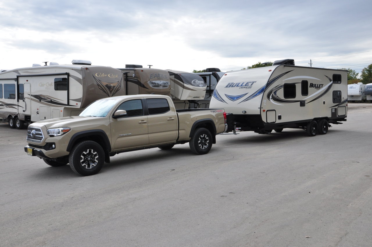

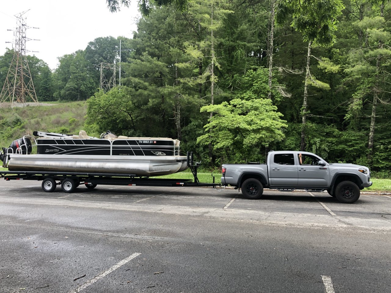

    Obviously a bigger truck will pull better. Just keep your dry weight about 4500# and under. Here is mine pulling a 25' tritoon with a 250HP suzuki. It is about 4500#, boat/gear & trailer. I have the tow package and trailer brakes. Just expect to keep your speed at 65 and under.
