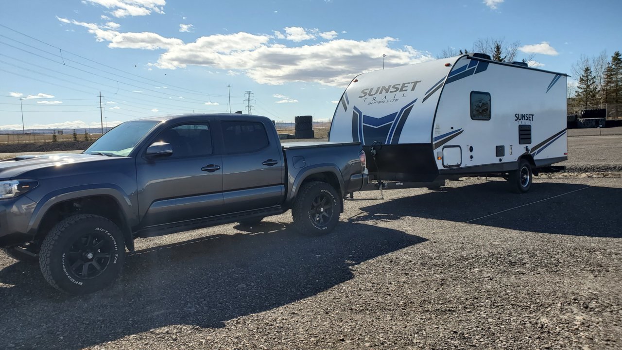

    You be fine. Proper WDH with sway control and brake controller it will tow like a dream. Nice trailer choice btw @4x4erik

    Dry weight is 3800. I hauled a full tank of fresh water (50 gallon) this weekend and noticed a bit of difference but generally the WDH does a good job of sorting it out. Allows nice even power delivery. Brake controller is also on one of its lowest settings too.
    Edit- cruising at 100 km/h is a bit of work if you want to be up there but I find 90 is the sweet spot (manual trans)
