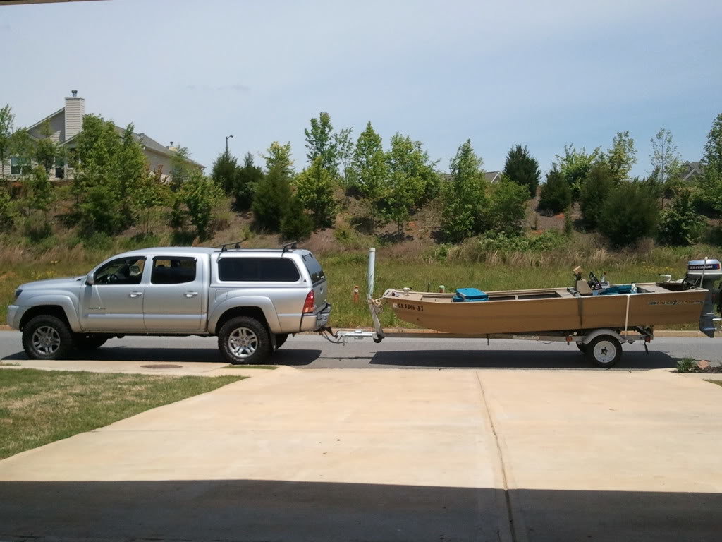

    While that trailer wouldn't be too heavy for bumper towing. The problem you run into with the Tacoma is that the hitch is too high. You pretty much need a drop hitch to keep the trailer level.
    Here's mine with a 4.5" drop hitch towing my 16' john boat. Granted I have a 2" lift in the back I still needed to drop it pretty far to get the trailer level

    Other than the rake of the trailer I'd have no problems doing that.
