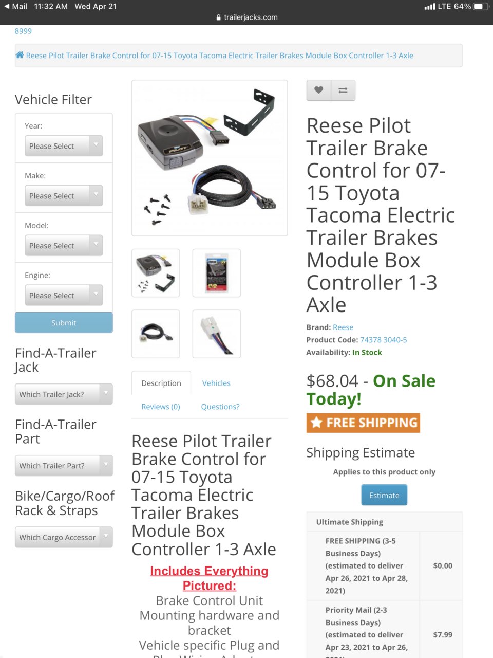

    It says vehicle specific plug. I sure ope so. I don’t want to splice into wiring if I don’t have to

    I would steer you away from that one. You want a proportional controller, one that calculates breaking power based on what its seeing on it's accelerometer.
    Ive been running the primus iq on my small trailer, and it does an ok job. The prodigy series is what most people run.

    Almost all of them have vehicle specific adapters, no splicing or guesswork required.

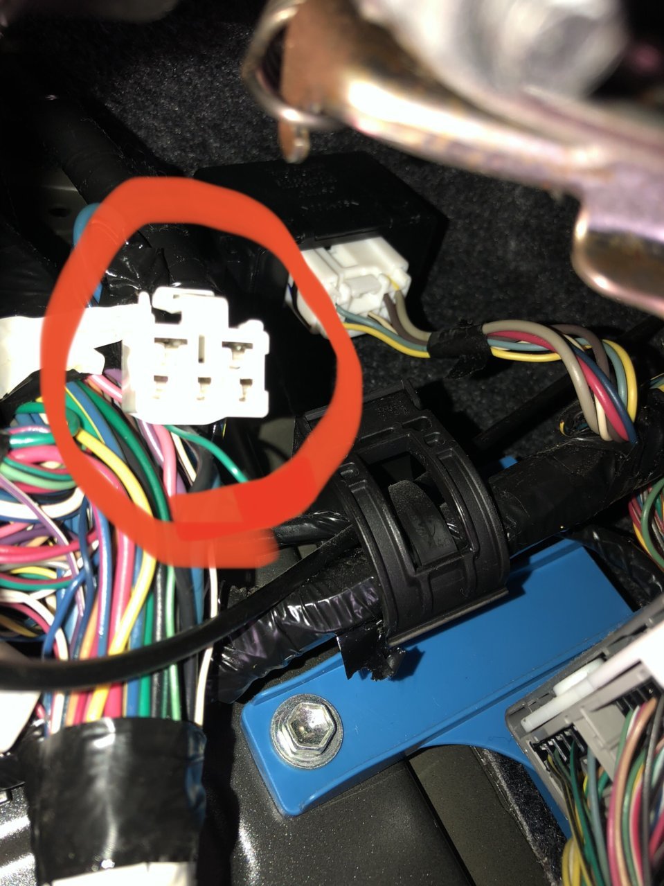

    Now I just need to find the freaking plug lmao

    Thank you! With the help of your photo I was able to find the correct plug. Thank God I have my entire inside torn down to bare metal, it made laying flat looking up a lot easier. I'm changing out the carpet for vinyl wanted to run everything while it was torn down.

    So glad you found it. It took me close to an hour. And a lot of sweating
