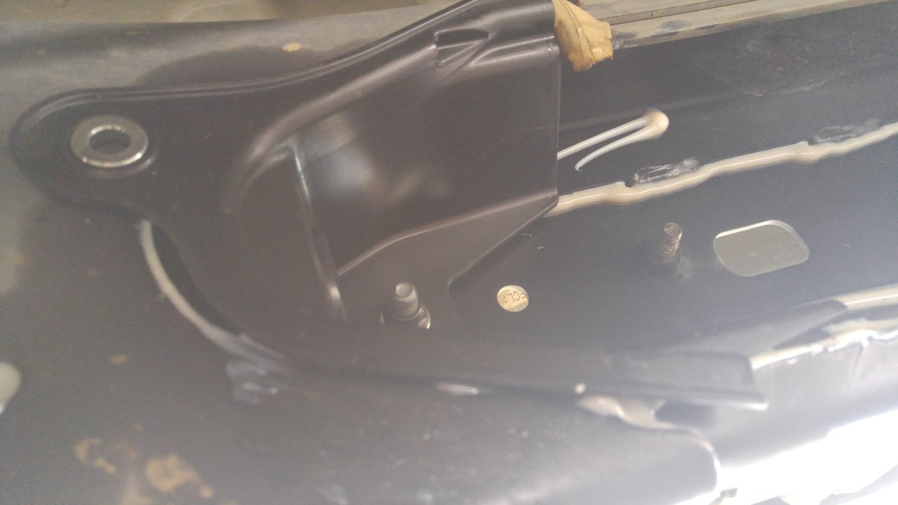

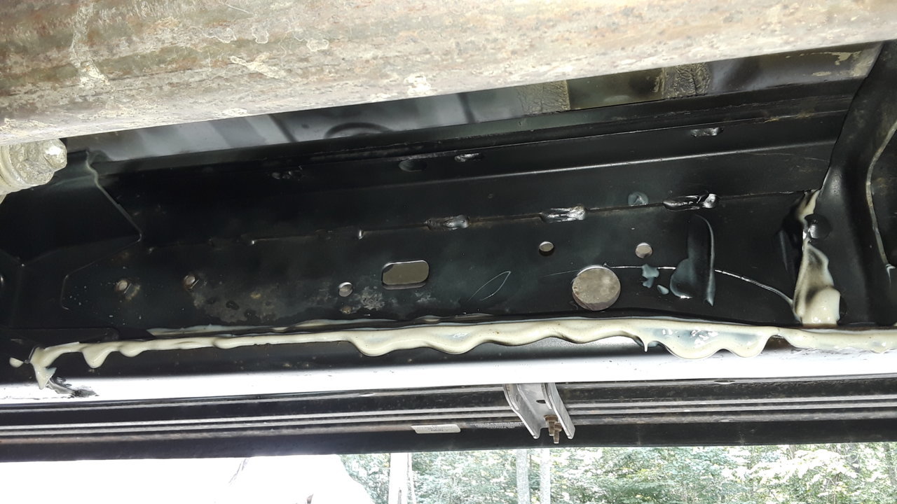

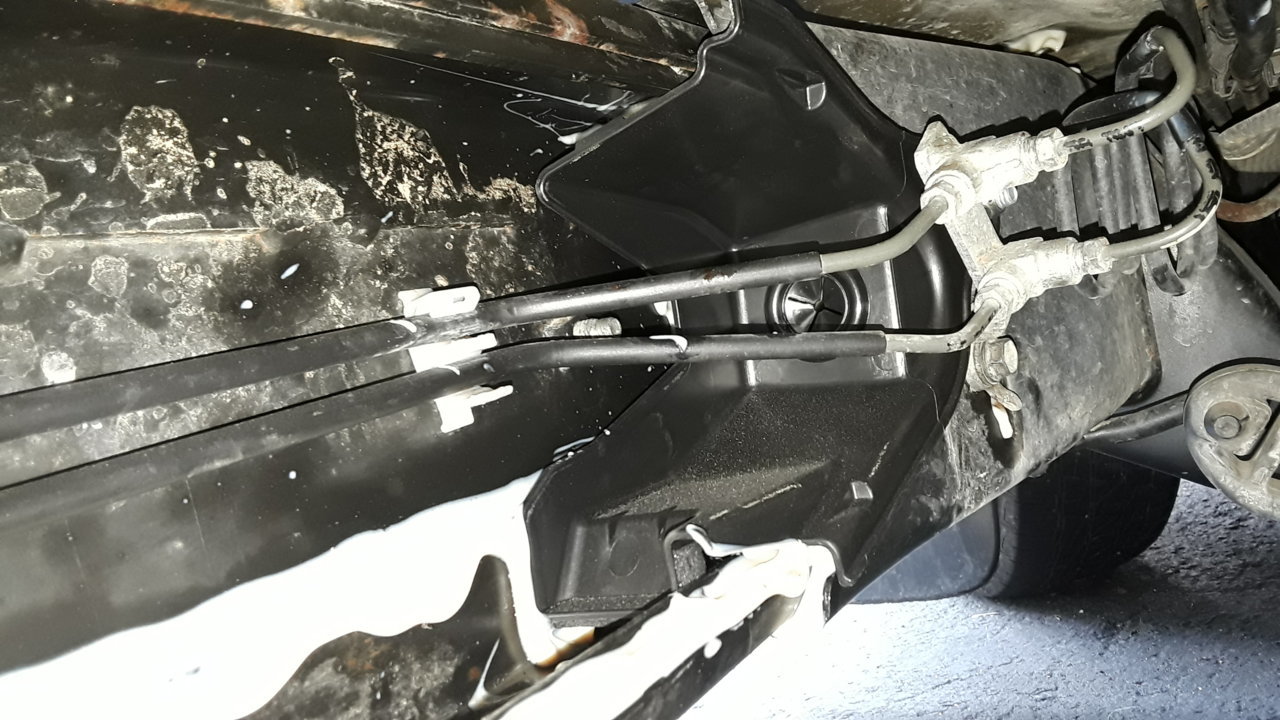

    To put it mildly, the CRC applied to my Tacoma under this service plan is a fucking joke. Five days later and it is as wet the day it was applied, after 80 degree plus days parked on blacktop. They put the caps on the front of the frame but the gaps are so large they are worthless and NOTHING was sprayed inside the front frame as it was supposed to be done per the tech sheet for this service plan. My five year old could have slopped this shit on better than the mechanics at the dealership.

    Full disclosure: I work in Service at a Toyota dealership. That said, I see nothing wrong with the application based on the pics that you sent. You state that "NOTHING was sprayed inside the front frame as it was supposed to be done per the tech sheet for this service plan." Only the insides of the box sections of the frame get the coating because that's the major area of concern. You appear to be complaining about the exposed areas in the C sections of the frame. They do not get coated as part of this program.
    As for it still being wet after the application, that's by design. Staying wet and pliable allows the coating to effectively prevent corrosion. (Instead of drying and flaking off like conventional rubberized undercoating.) If the coating stayed like that in an exposed area, that would be another issue. But since the coating is only inside the box sections, it won't get washed off.
    My bay is directly across from the bay where our trained technician does this process. It's not a lot of fun and he does a great job. (He did my truck.) People should learn more about the actual application before they throw stones.

    re-read my post; they put nothing in the boxed section except and inch or two around the front caps they put on; i removed both to inspect and nothing in there; what do i have to do, wait a year for this crap to dry on the exposed parts; there is already road dirt adhering to that shit just driving it home from the dealer and now 5 days later as wet as ever; stone are appropriately thrown when a junk rusted frame product needs "routine maintenance"
