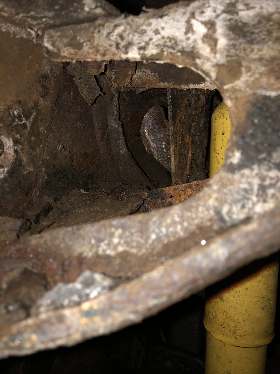

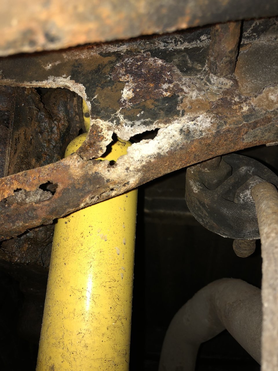

    Cool a new frame is good.
    Just had a guy here at work quailify for a new frame on his 1st gen. Said he had a shock mount break. Says he was gonna have a shop fix it. I was like what let’s take a look under there. Sure enough found holes.

    Pretty surprised he got somebody to weld his shock back. They never said anything to him and it looks like they used a battery and jumper cables to do the welding.
