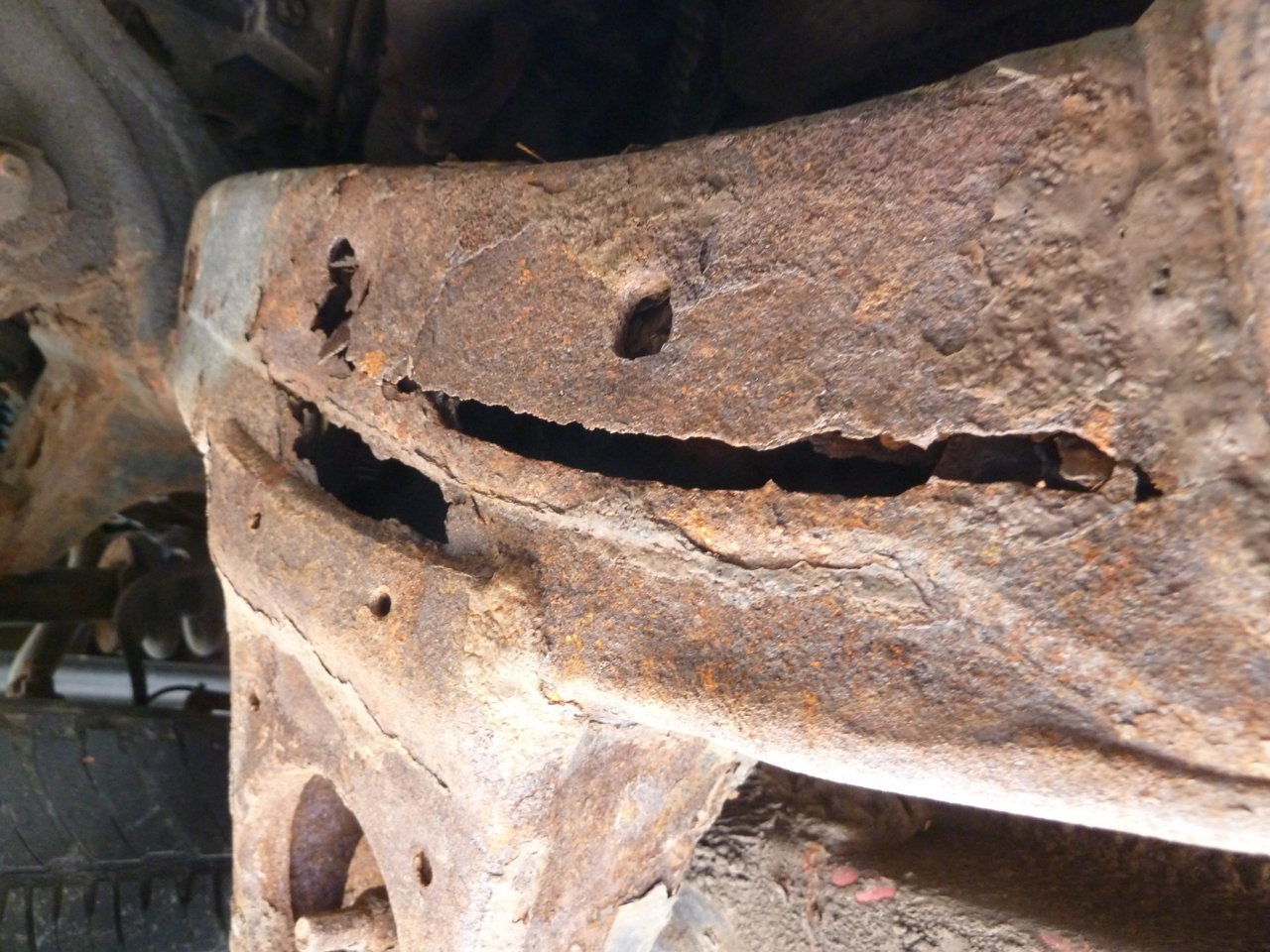

    _DSC0002 (2).jpg P1080585.jpg I am also in a 2006 access cab, but bought mine from Vermont in 2008 and brought back to Canada, it had 8,000 miles on it at the time. Had it inspected in 2016 at the local dealership here. It passed and sprayed it, they told me no worries. Changing the tire in the driveway in April 2019 and found the big hole in the frame and lots of rot. Went right into the dealer same day, but they told me the warranty ran out on January 31, 2019 missed it like by 63 days. Still fighting but I doubt if I can get anything out of them. Shame as only 73,000 miles on it and the rest is perfect.

    Toyota dealer just told me I had a rust hole on my 2006 while in for an oil change. I had the frame sprayed 4 years ago and was told that should alleviate any rust issues so did not have the frame replaced. Had my truck into Toyota several times during the frame replacement period and they never said anything about any frame issues and suddenly shortly after it has expired they mention I have this hole in the frame. Called Toyota today since I felt mislead about the frame spraying resolution and was told they will not do anything to remedy.
