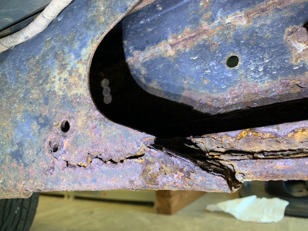

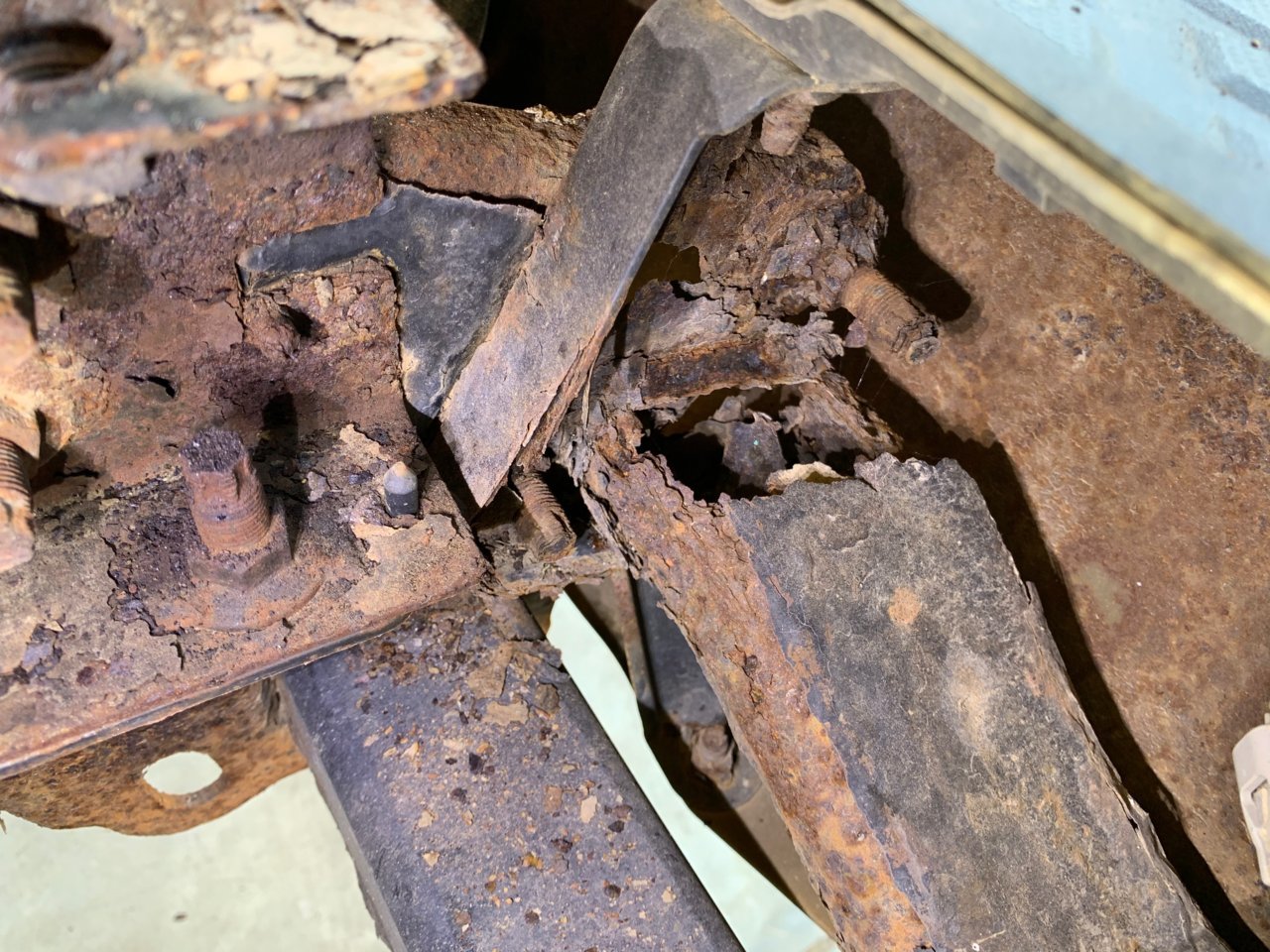

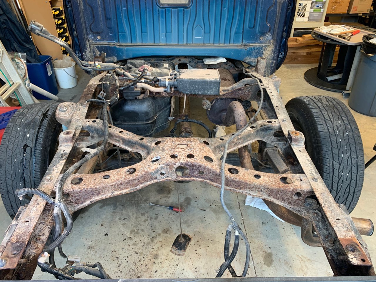

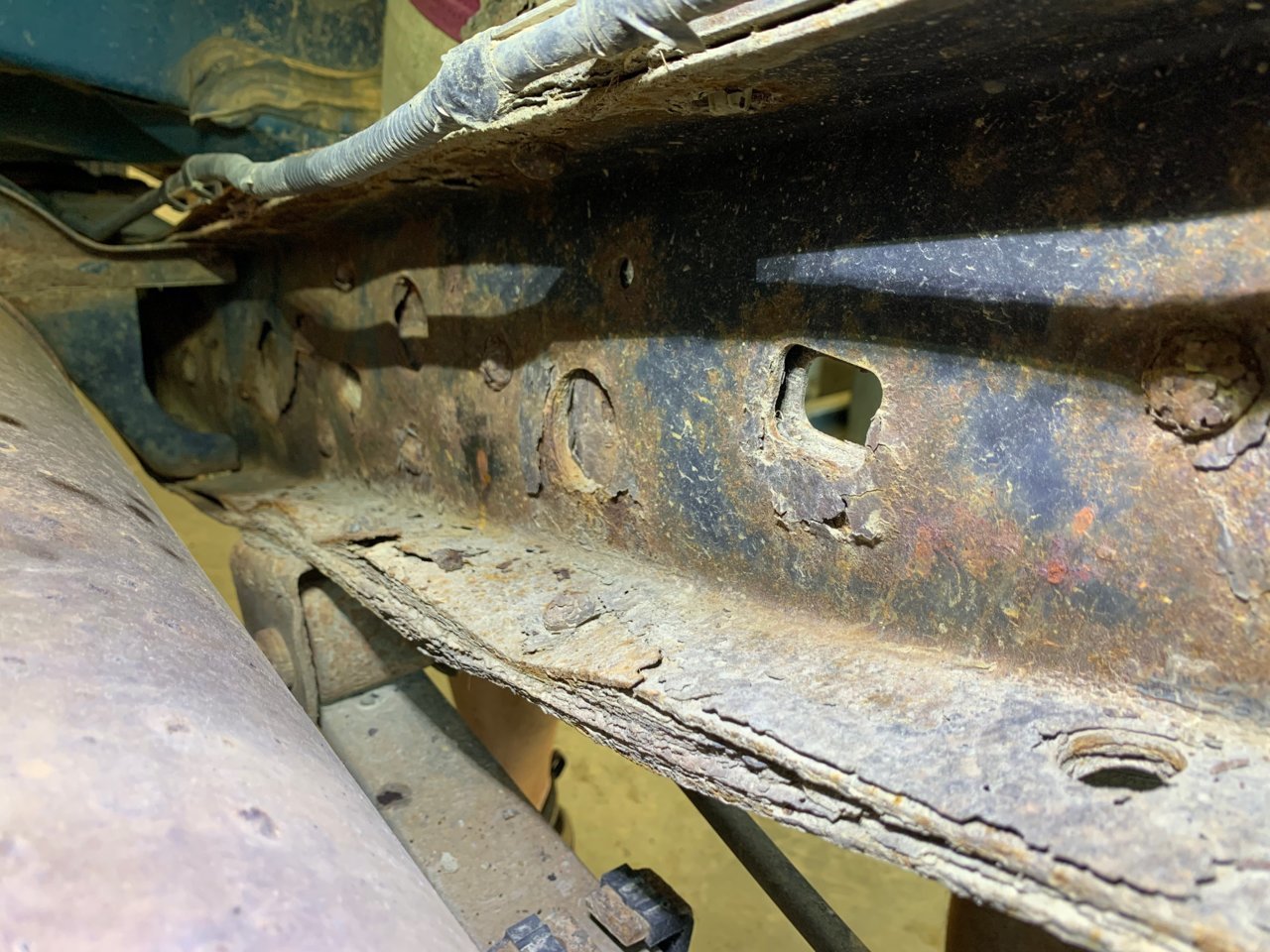

    Man, I hope someone can help me. I just stumbled across this post while digging for advice on what to do about the extensive rust I just discovered on my 2007 Taco. I'm the second owner, bought it from a Toyota dealer in PA in 2013. Looks like my truck is a 100% match to what all the class action claims were about, but since I'm not the original owner and this isn't a recall, the letter from Toyota never got to me. My local dealer told me it's too late for me to qualify for the enhanced warranty program. I called Toyota USA and got a similar answer. I put on my best humble/devastated voice and asked if there was any way to get some forgiveness on this, and was told I'd get a call back from someone else in a day or so.
    Any suggestions on how to find a sympathetic voice at Toyota who can stretch the term out a bit for me? The truck is paid for, and I don't really have the money or time to replace it right now, and I depend on the truck pretty heavily right now to operate my farm...

    I believe (and will be corrected if wrong) that your window closed last year. It's 12 years from first use and had to have had the CRC spray done. Ownership doesn't matter (I'm the second owner and have a new frame). You could try to argue but it's an uphill battle.

    You need to look for a replacement vehicle on your own. That frame is a safety issue.

    Wow. Thought my '05 was bad... please don't drive that off the farm.
    Unfortunately, Toyota Corp is not going to help you. I missed my deadline by a month and they told me to pound sand.
    If you think the rest of the truck is salvageable, keep an eye out for a frame on CL. That cancer has run deep though, you may have to cut your losses. Sorry man.

    I hope you don't get rear-ended (like I did this morning). If I had your frame it would have folded in half and the truck would have been totaled...
