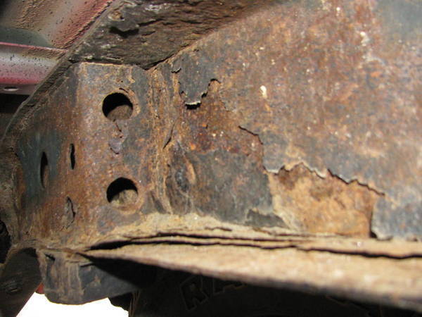

    [​IMG][​IMG][​IMG] My frame was rusted out and they replaced it because it was a 2001-2004. They didnt buy those back because if they gave us 1.5 times the value we could just about get a new one.
    That new new.
