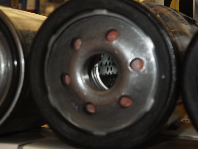

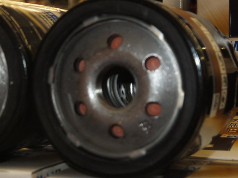

    While I don't have the money or time to be deconstructing filters just so I can compare the internals, I can say that it looks as though Mobil 1 makes a filter that fits our trucks, that is twice the size of the one listed for our trucks.
    Mobil 1's part number for our trucks is 102. After seeing its miniscule size, I took the liberty of looking through some of the boxes of filters on the shelf at my local Pep Boys, looking specifically at the taller ones to see if there maybe wasn't one that would work. I lucked out, in that the second box I opened appeared to be an identical filter that was quite a bit taller. Number 209 is the one I found.
    Before trying it out on my truck for its very first oil change (literally its first oil change. 3,028 miles on the clock), you damn well better believe I was going to make sure it was going to work. I looked the listed Mobil 1 102 and the larger Mobil 1 209 over very carefully, looking for even the slightest difference. The only thing I could see was the height. The internals were identical, and the base even had the exact same factory stamp on it ("AA").
    It has now been residing on my truck for 100 miles without incident. At 50 miles, it went to the dealer for an unrelated oil-in-coolant issue (which they tried to tell me was mud or dirt :facepalm: ); they didn't seem to notice/care about the filter that was on there, even after some prodding.

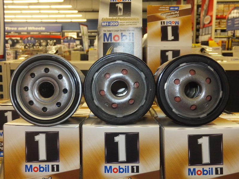

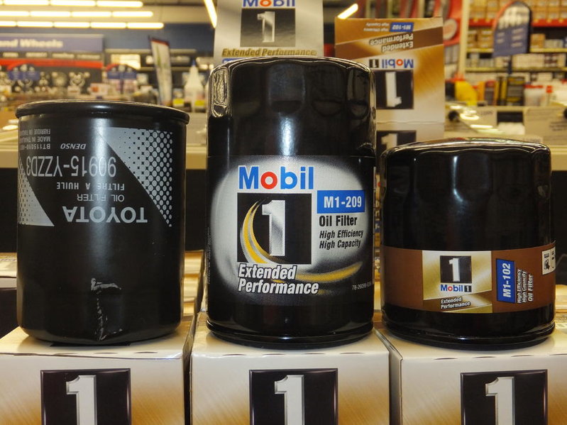

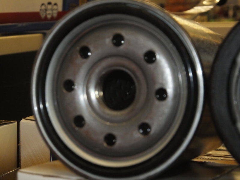

    Check out the pics below to see a comparison (taken in the store, with the old Yota filter still draining oil, is why it's upside-down).
    The right, shorter filter is the recommended Mobil 1 filter listed for our trucks. The middle, taller filter is the one I'm posting about. The base pics match the body pics (right = short, middle = tall, left = Yota). Note the bases are the same for both Mobil 1 filters.
    This new option should open up some discussion about surface area, as I suspect the larger Mobil 1 209 filter has more filtering surface area than even the Yota filter.

    The comparo I did was between recomended replacement filters. There are many that are larger/wider that fit the Tacoma.

    Photo shows 209, not 204, in case someone runs off with the PN to order it. :p
    There is more to filter compatibility than just fit. The bypass valve cracking pressure is also important. If the bypass valve on the 3rd-party filter is set too high, it can potentially cause oil starvation.

    The M1-204 may be taller than the M1-102, but that does not mean that there is a difference in the filtering element.
    This is the case with a lot of the fabled Amsoil EO filters... they use the same very short (Wix) element in multiple cans.
