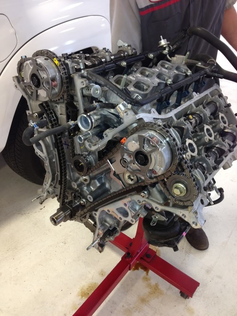

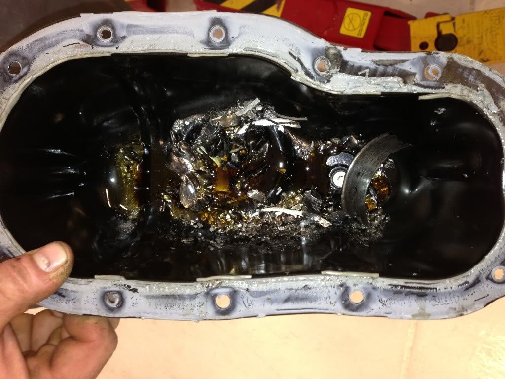

    Great info in here, Thanks Chris! I posted something on our local offroad FB page after walking thru the Toyota dealer I sell cars at and seeing a Tacoma with the engine pulled. The mech. told me it was there because he used a fram oil filter on it! With only 4,500 miles on the engine that motor needed a rebuild because of oil starvation! The customer liked to do his oil changes every 3k mi. He should have seen this thread first!

    So that happened after only 1500 miles on a Fram?
    Sorry... that may be what the customer told the tech, but as crappy as Fram oil filters are, it didn't cause that. Customer either forgot to replace the oil, then put it in before having the truck towed in, or downshifted at high speed.

    Yeah, I'm guessing he forgot to put in the oil.

    I don't think the Fram filter did that damage either. They (or someone) was just looking to place blame somewhere. I used the Fram filters for the past 108k miles on my last Tacoma and never had any problems. But I did use oil along with them so I guess that may have helped! :) Not saying maybe somewhere some time ago there was a bad batch but not in this case. Either way, I got a dozen OEM filters for $4 each so I will be using them.
