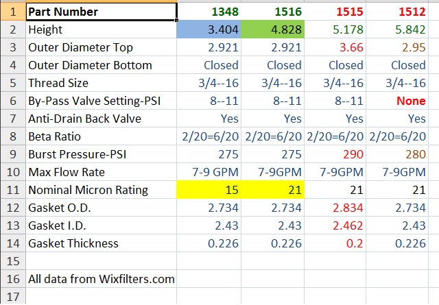

    Sounds good. I did a little more research on the 1512, which I have not used (I use the 1516). The 1512 is indeed a lot taller, but unfortunately does not have a bypass valve, even though all other specifications are the same except for a nominally higher burst PSI.
    I will send ya the 1516 and M1-209. The only difference from the Wix website between the 1348 (the 'stock' filter) and the 1516 (the bigger one) other than height is the nominal micron rating, which is 21 instead of the 1348's 15. The only thing I understand from this is that is does not filter particles that are less than 21 microns thick.
    I got bored.. some other folks out there suggested the 1515, 1512, and 1068. Don't bother with those.

    it was explained to me, that you want a filter that filters out things smaller no larger than 20 microns. Modern engines can be damaged by particles 20 microns, or larger. I haven't seen hard data to back this up, but it cam from an engineer at caterpillar. I guess take it for what its worth, but I try to use filters that filter smaller than 20.

    Hmm, so even though the 1516 is larger, it doesn't seem to filter as well (according to Wix's website). That would bust a lot of theories about the larger filter doing better. Even though it technically can filter more, it doesn't because the material doesn't filter >21 microns.
    The unusual thing is the beta coefficient...er, ratio is the same, meaning both filters are rated to be 50% efficient at filtering particles 6 microns and 95% efficient at filtering particles 20 microns.
    Interesting article about "nominal" micron rating vs beta ratio filtration measurements.
    http://www.machinerylubrication.com/Read/1289/oil-filter-efficiency
    If beta ratio is the true measurement on the Wix website then both filter equally as efficiently. One just has more filter material.
    All this being said, I will probably go ahead and get the Toyota filters from now on.
