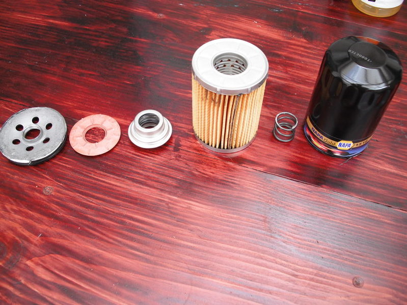

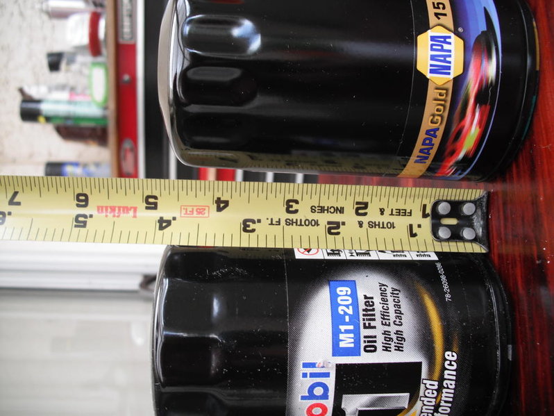

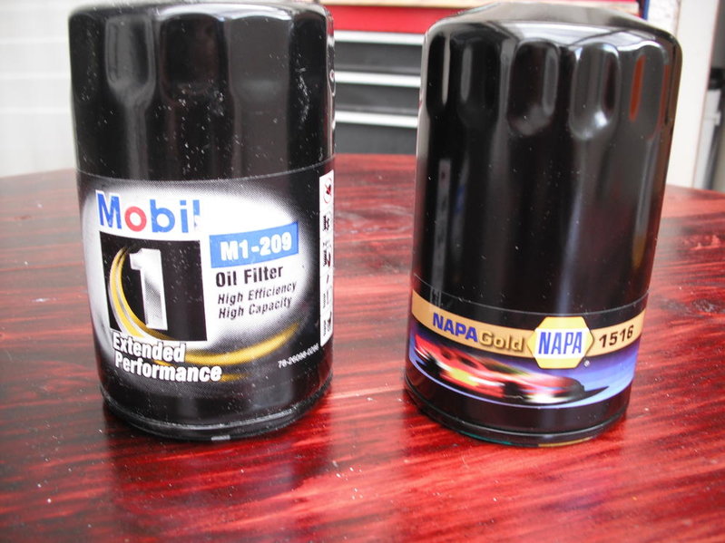

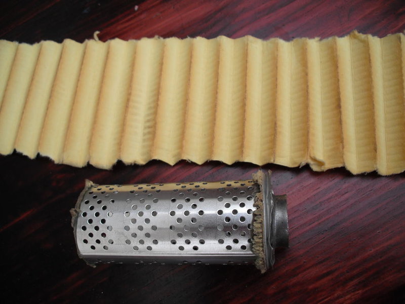

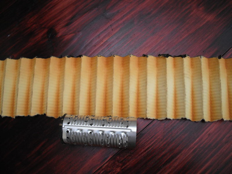

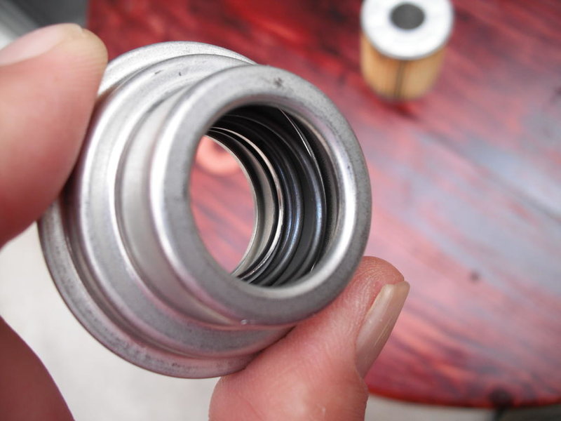

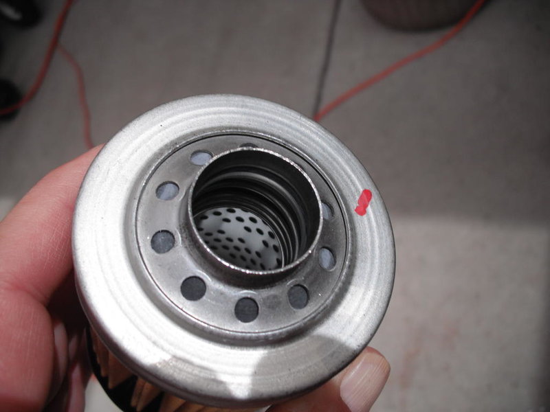

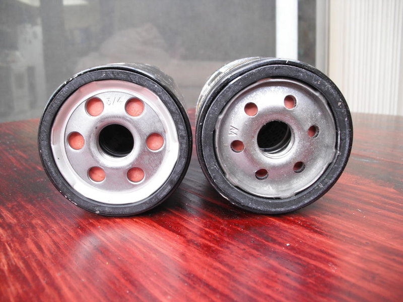

    Special thanks to thunderone for sending the 2 newest filters to check out. A NAPA Gold 1516 ($5.99), and a Mobil 1 M1-209 ($11.99). Both of these are a +1 size up from the OEM replacements, so lets see how they stack up!
    First, here are the 2 side by side:
    The NAPA is slightly taller than the Mobil 1:
    The NAPA Filter has larger holes, allowing for less restriction (NAPA on left):
    The components:

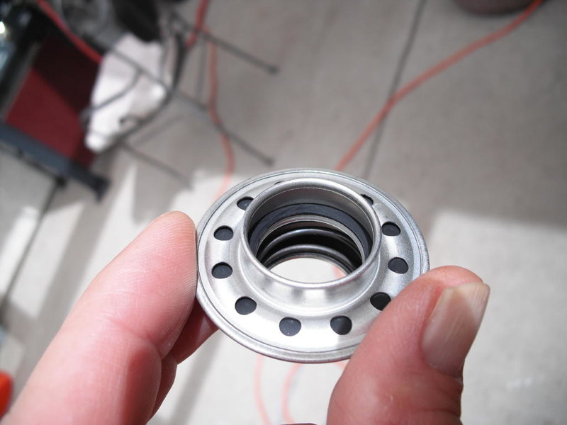

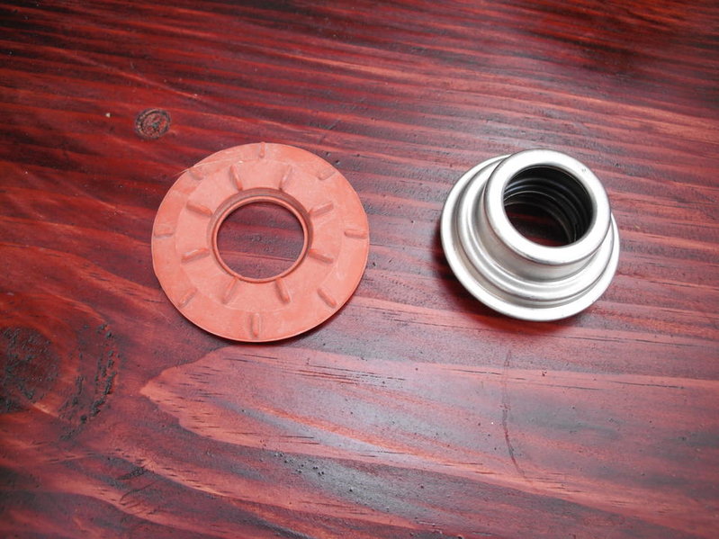

    The NAPA has a unique anti drain valve, as its an "All in one" unit:
    And the components of the Anti drain back valve:

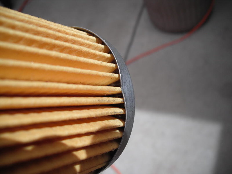

    The NAPA Gold has 210 sq. in. of paper/cardboard filter media:

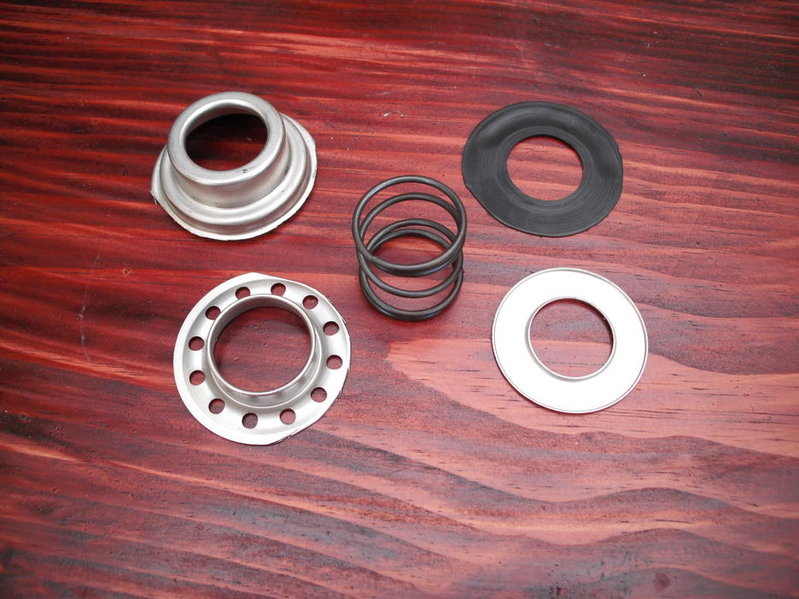

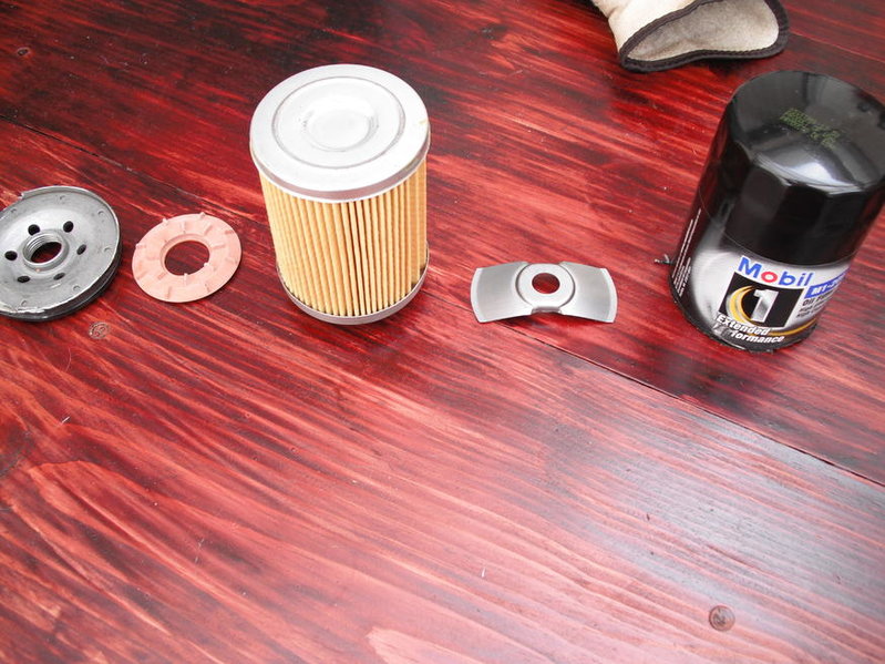

    Here is the Mobil 1 M1-209 ($11.99):
    Components:

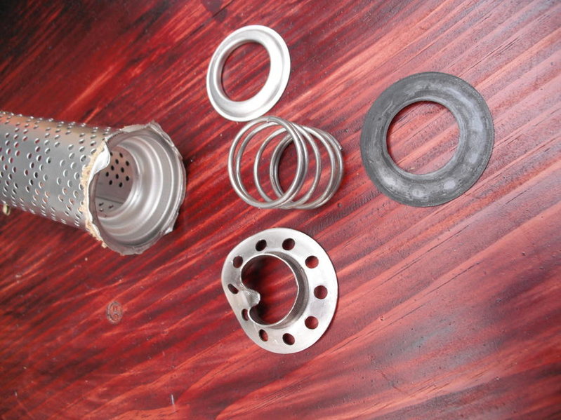

    The Anti drain back valve, although claimed to be "Patented", is very similar tot he NAPA:
    Upon disassembly, the filter canister had all sorts of flaws, including this dent. The outside was perfect, but there were all sorts of bends, and dings in the filter canister. Not a big deal, as this doesn't affect how it works, but for the money, you would expect a little better quality control:
    Mobil 1 claims the filter media is "Synthetic Fiber Blend", however, its the same media as in the NAPA Gold filter, but only 171.5 sq. in. of filter media.
    I had to bust my ass to get the internals of the anti drain back/by pass valve apart:
    personal note:
    The adhesive that Mobil 1 uses to hold the media, and center tube together, makes epoxy resin look suitable for use by pre school children. Never in the past, have I had to fight a filter this hard to get it apart. I have a strange desire to Email Mobil 1 and tell them either:
    A. Well Done!
    B. HA! I BEAT YOU!
    C. Go fuck yourselves!
    Regardless, this filter shouldn't come apart unless your truck explodes, and even then, I would bet on the filter.

    Interesting to note, that despite the larger size filters, the OEM Toyota Filter STILL has more filtering media!
