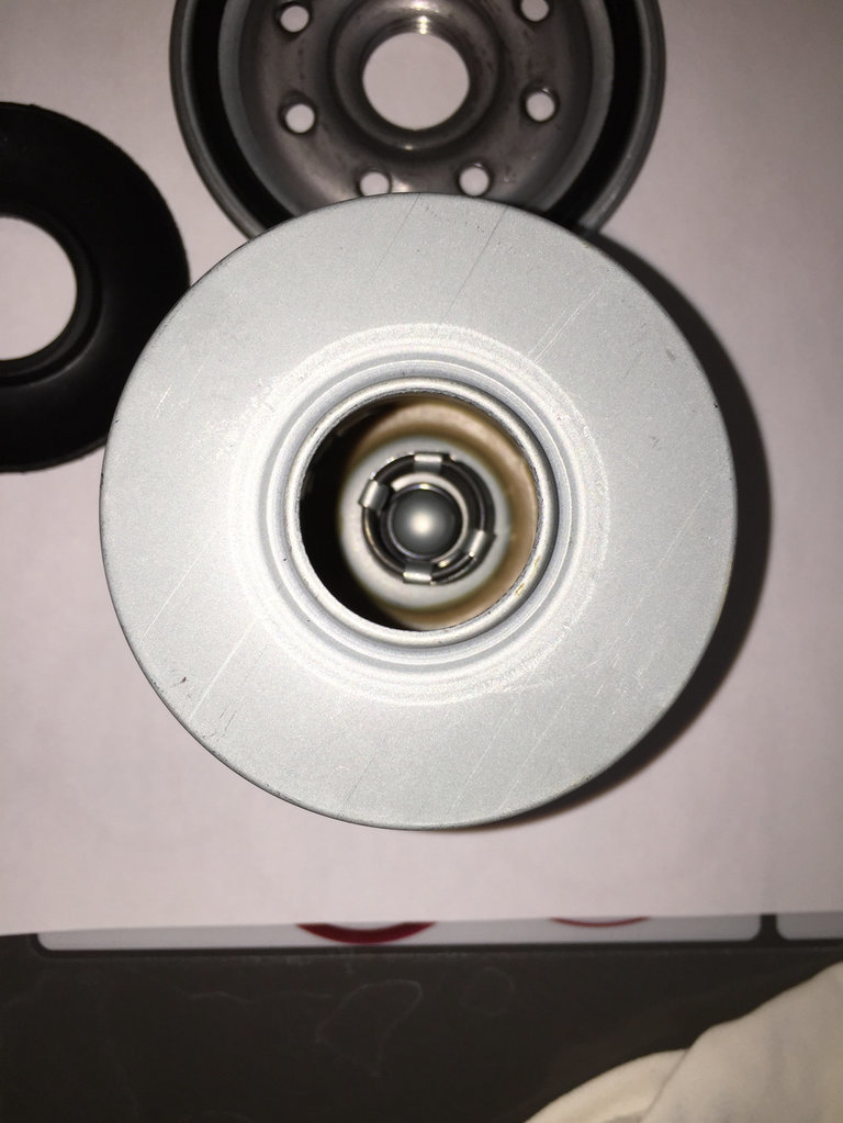

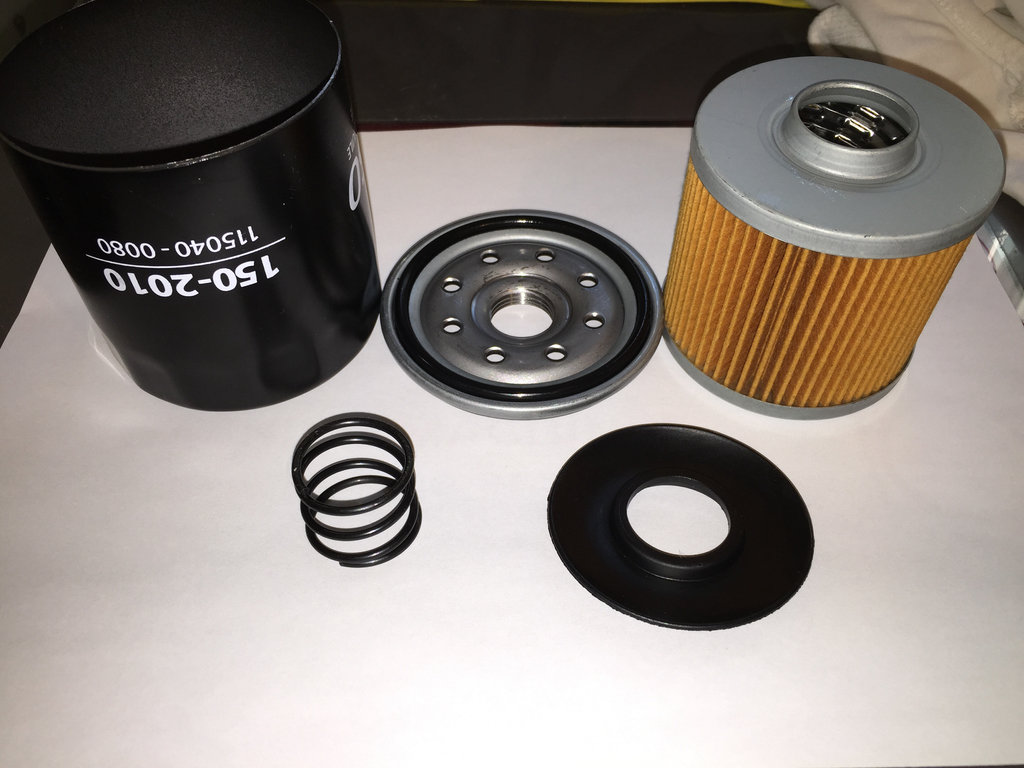

    Denso's aftermarket filter P/N 150-1003 has been replaced by P/N 150-2010, now made in China. Dissection by rustypigeon on BobIsTheOilGuy shows good build quality, though like the 150-1003 before, it lacks the design innovations of the made-for-Toyota filter:
    a0381f502d69ca0ceefd36beec0eaa02_zpsxvnc_25779a4fd3fb4c18fb6e419345a313e47b017207.jpg
    6e820a877d6c6c91c0f267593255f657_zpsoumr_aeadf9adaf527cca14b1cd55042c73f154def2ce.jpg
    59a975e17f0bdf11b83a3088ff60ec8f_zps2q42_83a098c8cf9e606781411a5079fd82042f5aa750.jpg
