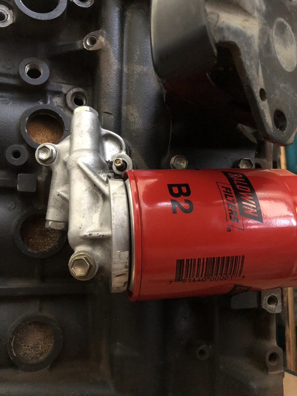

    Grind off the tab to allow for grande filer choices now

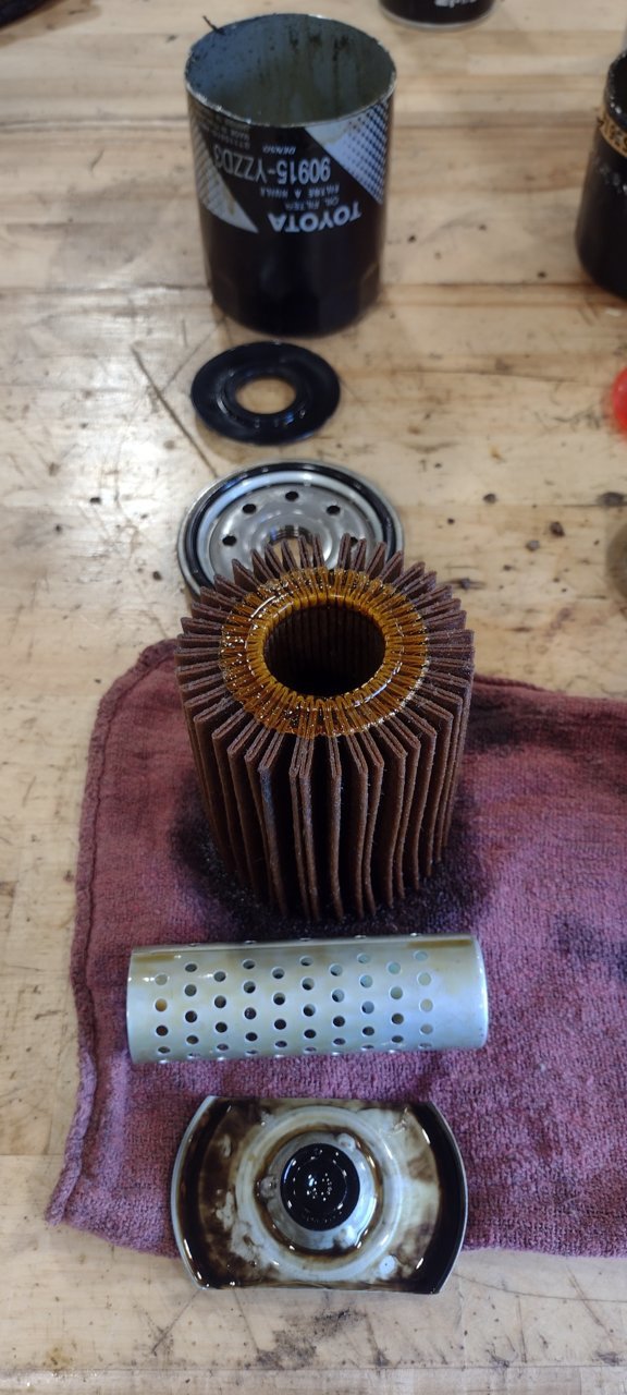

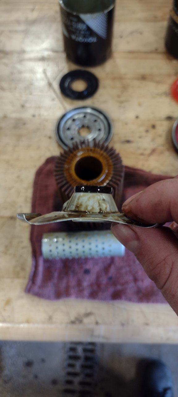

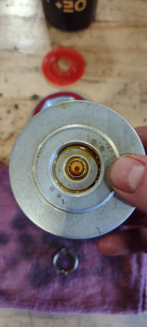

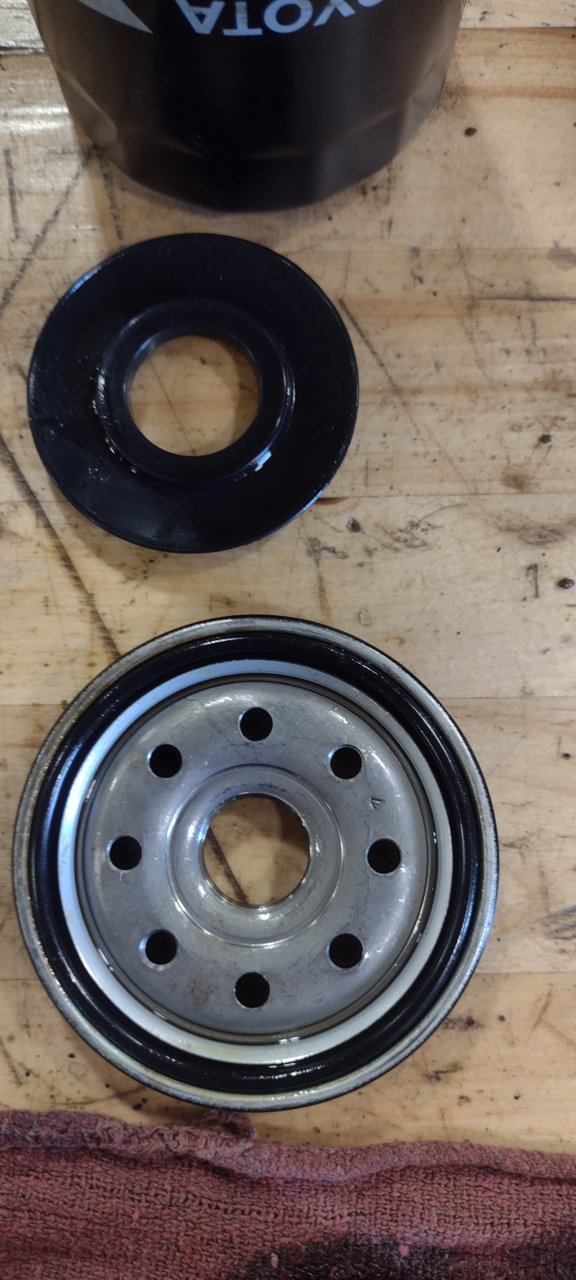

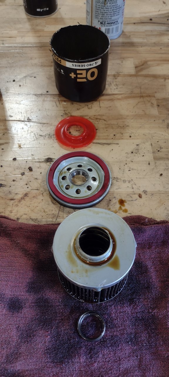

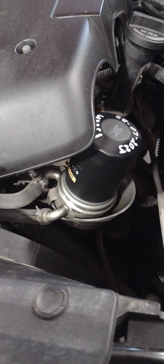

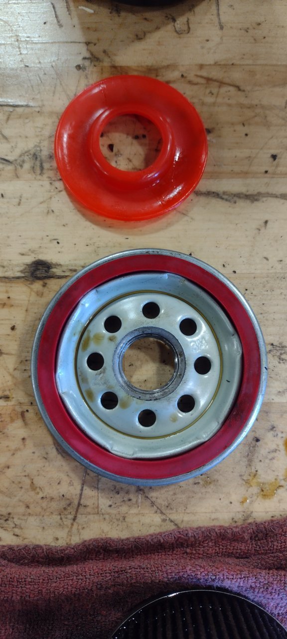

    So today I compared the Toyota YZZD3(PRS3600) and the Part Source OE+ PRS3614(YZZD1). Both filter have 5000km and were used with 5W-30 Synthetic oil.
    The metal housings are the same they both have a silicone anti drain valve and O-ring. I preferer the OE+, reasons for this include that the filter is capped at both ends, and the bypass vale is integrated in the filter canister unlike the Toyota that is glued and the bypass valve is just sitting on the bottom of the filter held with spring pressure that would have the possibility of leaking between the valve and the filter. The spring in the OE+ is only to hold the filter to the bypass valve sandwiching it to the bottom of the filter. The OE+ filter is textured for your pleasure and in my opinion is a great quality replacement filter for $11 Canadian. If you'd like the larger version the OE+ PRS3600 is slightly taller that the YZZD3.IMG_20230728_103638608.jpg IMG_20230728_103645161.jpg IMG_20230728_103653084.jpg IMG_20230728_103649880.jpg IMG_20230728_103714372.jpg IMG_20230728_103721359.jpg IMG_20230728_112147666.jpg

    that OE+ is double the price of the toyota one though. i buy the YZZD3 by the case form Amazon and it works out to ~$5.50/filter

    Last time I bought a Toyota filter it cost me $13.72. the OE+ cost me $7.53 with my discount at Partsource.
