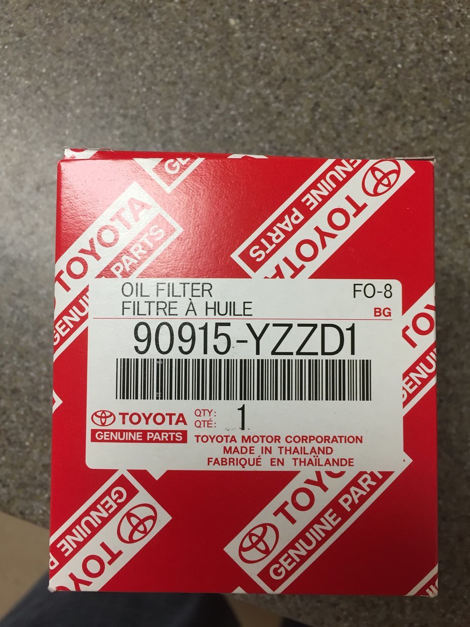

    I got mine from @gunny1005 who works at Camelback Toyota for $3.58 a piece. So I bought 10 of them. The 90915 - YZZD1 is for the 3.4, but some people do use the larger YZZD3 for more filtering ability. Plus w/ gunny, there's no shipping or tax and a TW discount. The tax only applies if you live in AZ. Obviously, 10 of them was $35.80 OTD.

    You can use either the D1 or D3, both have the same threads, D3 is a little longer and that's the one I've used in the past because it allows me to dump an even 6 quarts in the engine and not have to worry about toting a half quart around that inevitably starts leaking from around the cap before long.
