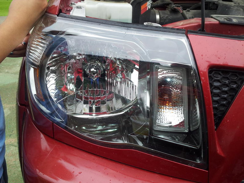

    Both my DTRL's were burnt and cracked to hell. 72k got them installed today. Looks great, the chrome in the lights seem darker, almost seem blacked out but not. Maybe it's the reflection picking up my paint.

    The lights are amber just get level with them. They cut them in a way the amber is more focused dead center and less so @ 90 degrees. Also the housing seems to be more of a gun metal grey than chrome, to me at least.

    Got the letter, my passenger side lens had bubbled and cracked a year ago and the headlight filled with condensation since then, too.
    My dealer said the 'enhanced warranty' only covered the one lamp and not both. I protested because after the replacement, I now have one clear and one older amber lens lamp. The service writer said the older lens was clear and only turned amber with age!
    The manager took photos and said she would contact corporate and see if they will replace the other... a day later, the call came and I was told NO, only a defective lamp will get replaced.
    How about it guys, is this BS from my dealer or will Toyota only warranty a lamp that has melted/ cracked and not the pair, so the truck has the same colored lenses on both sides?

    Toyota is announcing a Warranty Enhancement Program to cover the replacement of the headlamp assemblies if the inner daytime running light/turn signal has become
    distorted or bubbled in appearance.

    you didn't read far enough
    Repair Program
    3717JA
    Replace both headlamp assemblies, including adjustment for aiming
    2.5 hr./vehicle
    Note: If the vehicle is still under the New Vehicle Limited Warranty, submit the repair as a Regular warranty claim
