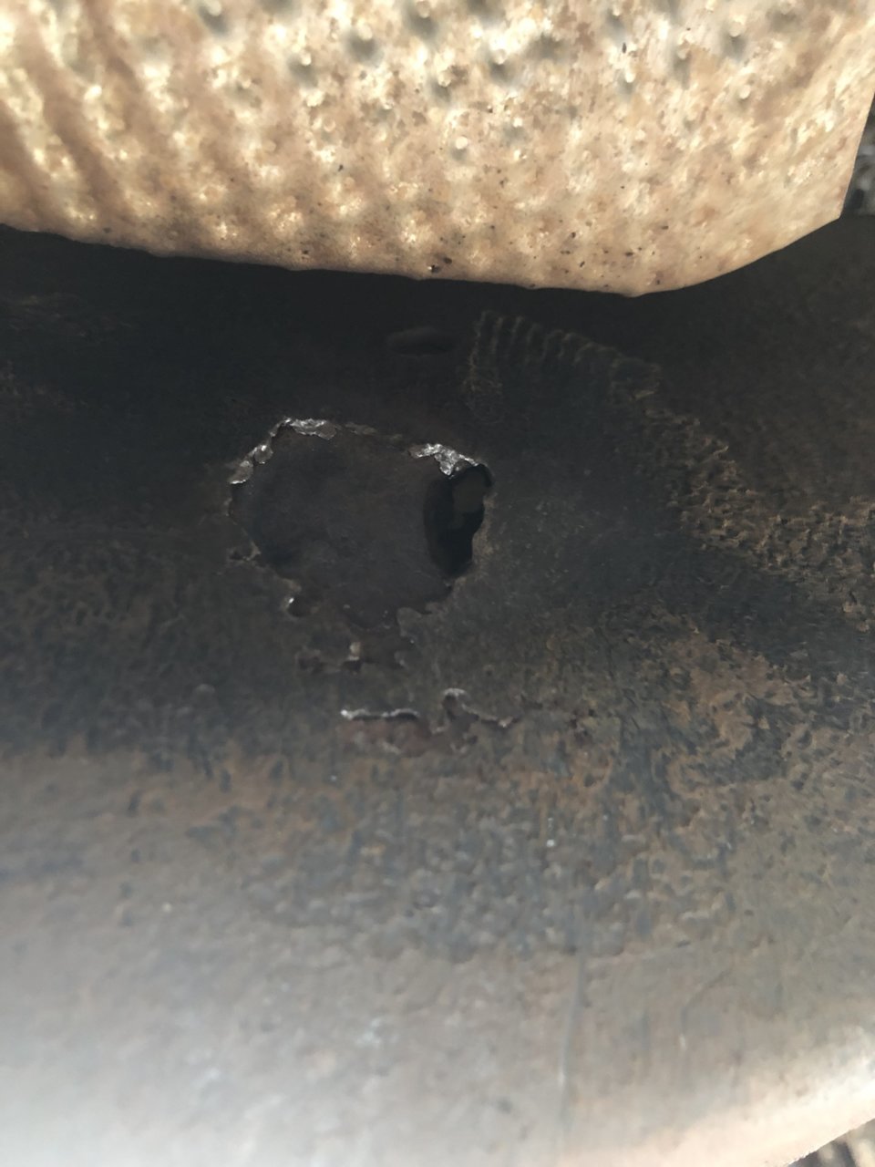

    That doesn't look bad to me. It has to be a structural problem. Here's what mine looked like.
    They replaced it few years ago and the replacement looks like yours now. So I can tell you the new ones aren't any better. Keep that one as long as you can.

    My 2010 failed. The place that they checked was by the 2nd cat on the Y pipe, drivers side. Hit it with a hammer. It went through, thus failed.

    Take a punch and hammer on it in different places. You'll know right away if it's bad, it'll go right through. That's how the dealer tests too. Sorry but i have to laugh at the borescope idea. Mine was so bad I put my finger through it and this was only a year or so after I watched the dealer do the hammer inspection.
