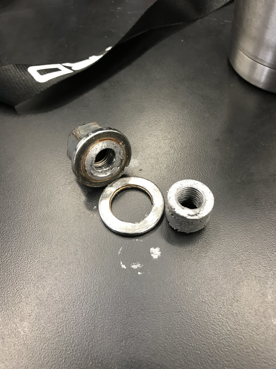

    Just came across this issue. Taco came from another shop for a tire replacement and this is how the lug nut came apart. Just sharing on here. First time I've seen this happen personally.

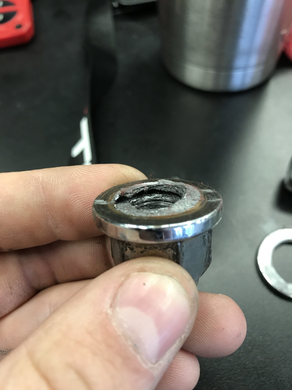

    Here's a closer pic

    Wow...never seen that. They got a lil happy with the air gun.

    For lack of a torque wrench , or the sense to use one.

    Looks to be over tightened.

    Some one doesn't known when to let off the impact trigger

    Factory lug nut torque is only 83 ft lbs. A good impact can easily exceed 300 ft lbs.
    Hopefully they didn’t damage the threads or stretch the stud

    When a torque wrench is used and set right, 83 ft lbs is really not that much. I always see people really push/pulling on a tire tool to tighten lug nuts and just think how over board it is.

    Can cause rotor warpage too

    Way too much torque

    I have had that happen on my truck and they never seen air tools of any type and torqued to 80 ftlbs.
    I think the design of the lug nut makes that the weak spot.
    You can get new ones at napa for about 2 bucks apiece.
    I run summer and winter tires so every year I go to napa and buy a couple to change out the ones that the cover is getting mucked up on.

    I've been using these lug nuts for 20 years. I have never seen this before with hand tools

    Some people shouldn't be allowed to use air tools.
    Personally, I only every use my impact to remove stuck bolts or fasteners. I live in the rust belt, so my impact saves my rear more times than I would like. But what ever goes back on is done with a ratchet and torque wrench, lug nuts included.
    Sorry this happened to you OP. Like someone else said, check to see if the stud is damaged. If not it's not expensive/hard to replace, but a pain in the ass no less.
