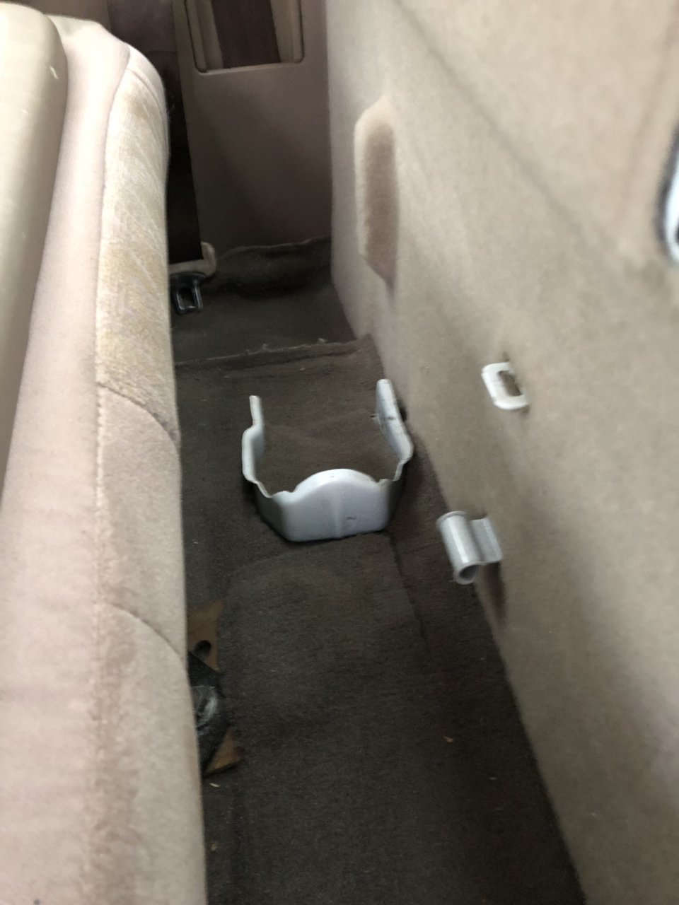

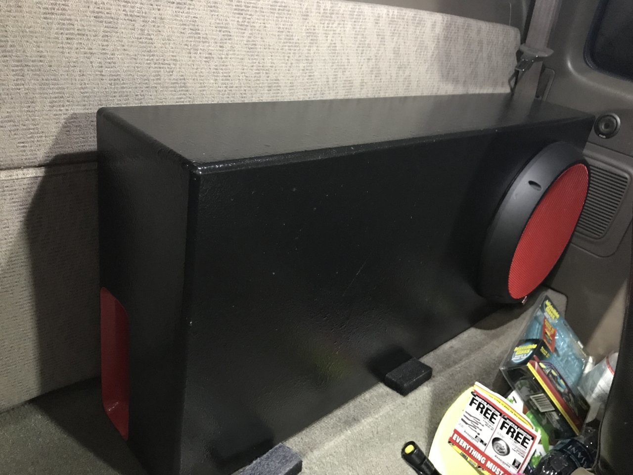

    The disappointment lead me to look at the dual 8’s enclosure sold by Supercrew sound. The website says that “all hardware on the rear cab wall needs to be removed.” I installed 2 Kicker 40CWRT82s without clearance issues. Installing the enclosure behind the rear seat was another story. The problem is the area where the bottle jack frame is located. The vertical space between the top of the jack frame and the bottom of the rear wall crossmember is 8-8.5”. The height of the box in this location is 9”, so modification is necessary despite the “guaranteed fit.”
    Instead of cutting out the jack frame, I chose to modify the enclosure
    After modifying the box, it’s still a tight fit and I used grill covers to protect the sub. The subs are advertised to require .30 cu. ft. of space and this enclosure provides .35 cu. ft. on each side. This setup gives a superior sound that fills the cab and blends well with the door speakers. There is no drop out towards the top of the cab as with the single 10”. This is definitely the superior setup. Don’t waste your time with the smaller enclosure, if you can even find it.

    I realize this is an old forum but how were you able to modify the box with that much as supercrewsound sent me the same box however not with even close to that much room too cut out of the enclosure.

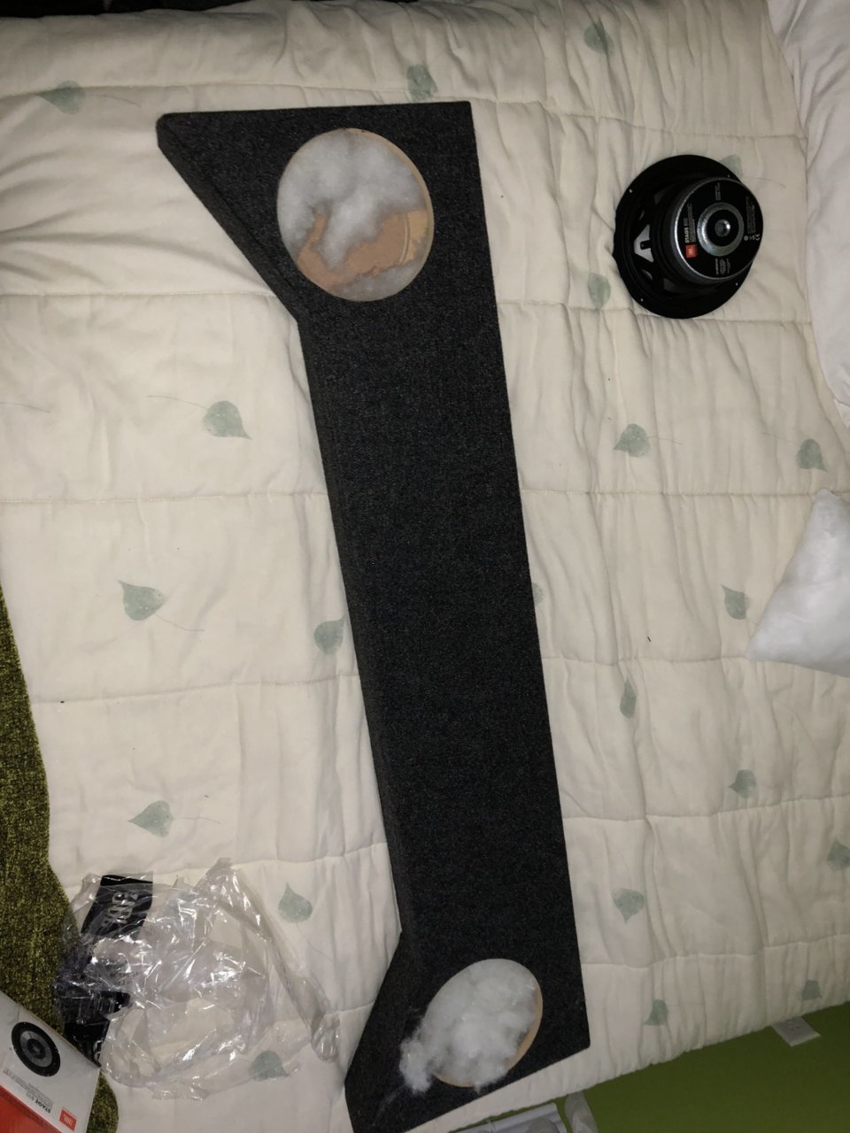

    This is what they have sent me, not really any room to make a notch unless like you said, there was an extra piece added between so for the bottle jack frame.

    That looks the same. I'm wondering if earlier years had a different setup for the bottle jack. I've got an 04.

    Look any similar?

    Yes, exactly the same. Hopefully your woodworking skills are better than mine.

    The box worked great, I went too my local sound shop too do the work because I just didn't have the craftsmanship too do so. However they cut the bottle jack out and showed me that the JBL Stage 800 Subs did not fit in the box provided to me by supercrewsound.com So I had to send those speakers back and the sound shop but some in, and you know how that goes. They charged me $120 for cheap $35 shallow mounting subs each, both 8"s audiopipe. (Going to buying a highend shallow mounting sub instead, rockford fosgate). But they all actually dont sound bad too be such cheap speakers. But sucks to be overcharged as when I took it to the sound shop they said my amplifier was broken and they installed me a new one charging me $170 for $50 amplifier. Will never go back there. But other than it not being able to handle bass tests, its sounds really good and will be an easy switch for the new subs. Also looking into puting new door speakers and tweeters and re doing all that.
