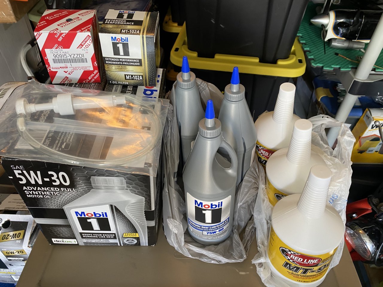

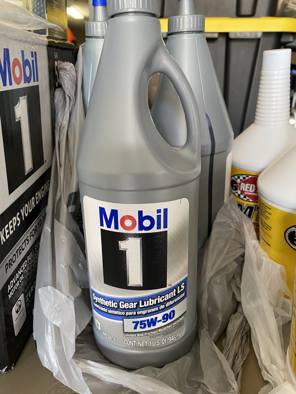

    Oil: mobil 1, 5-30
    Oil filter: mobil or toyota? I have both, suggestions?

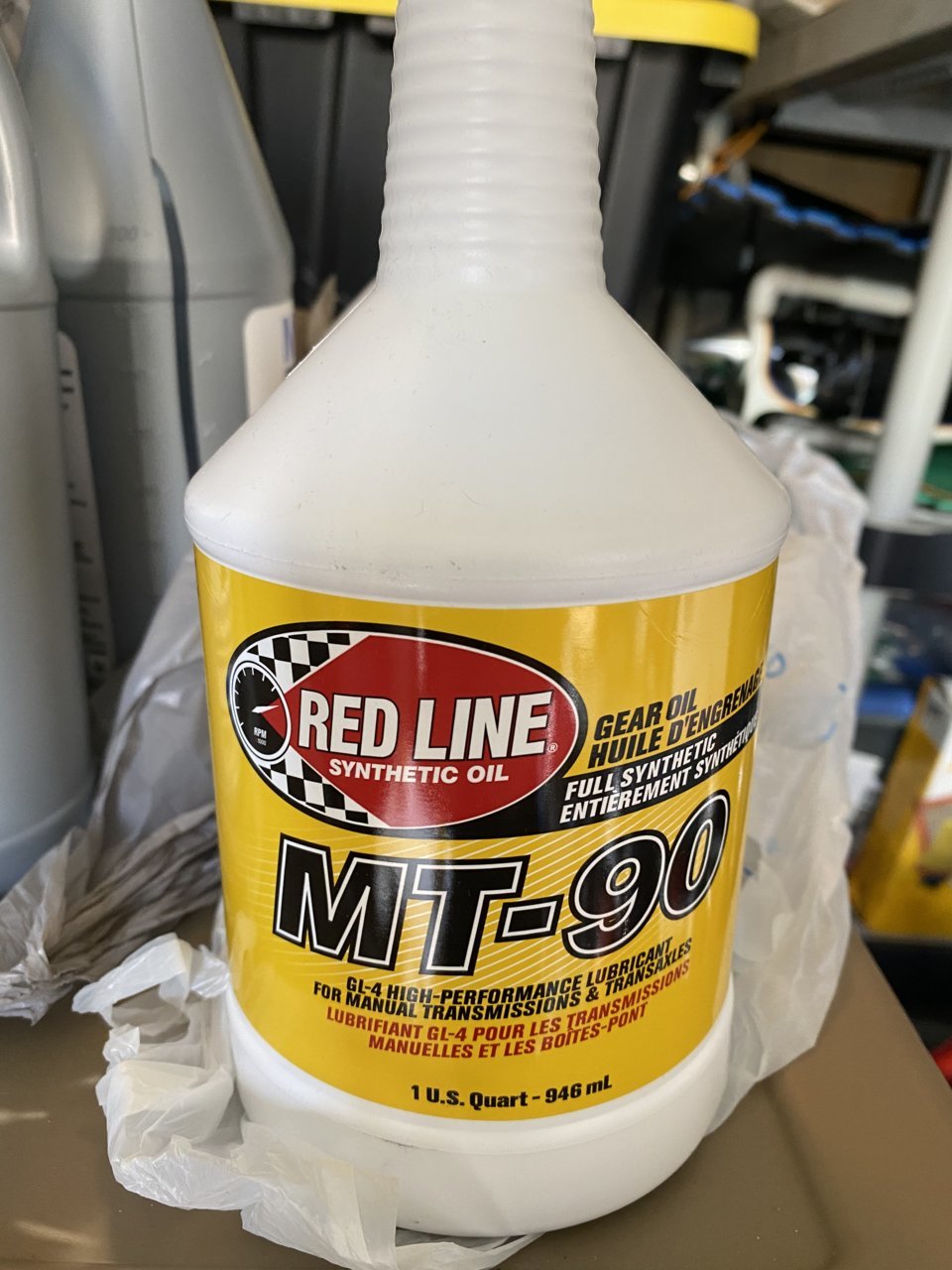

    Transmission: Redline MT-90 GL4( 3 quarts)
    Rear differential: mobil 1 75-90 GL-5 (3 quarts) the book calls for 75-85, i am going 75-90, any advice?
    Any info on fluids capacity?

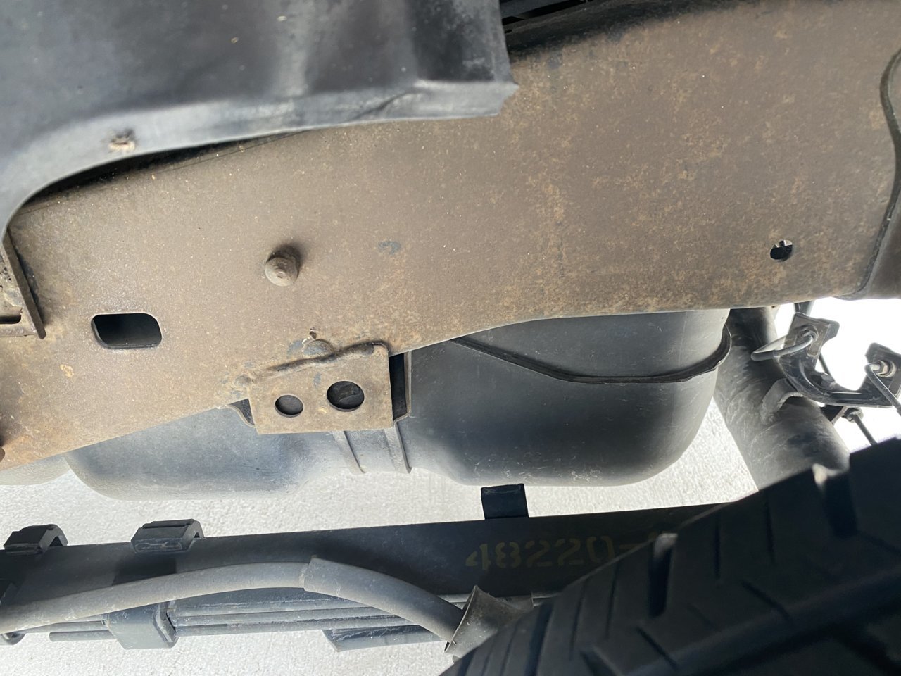

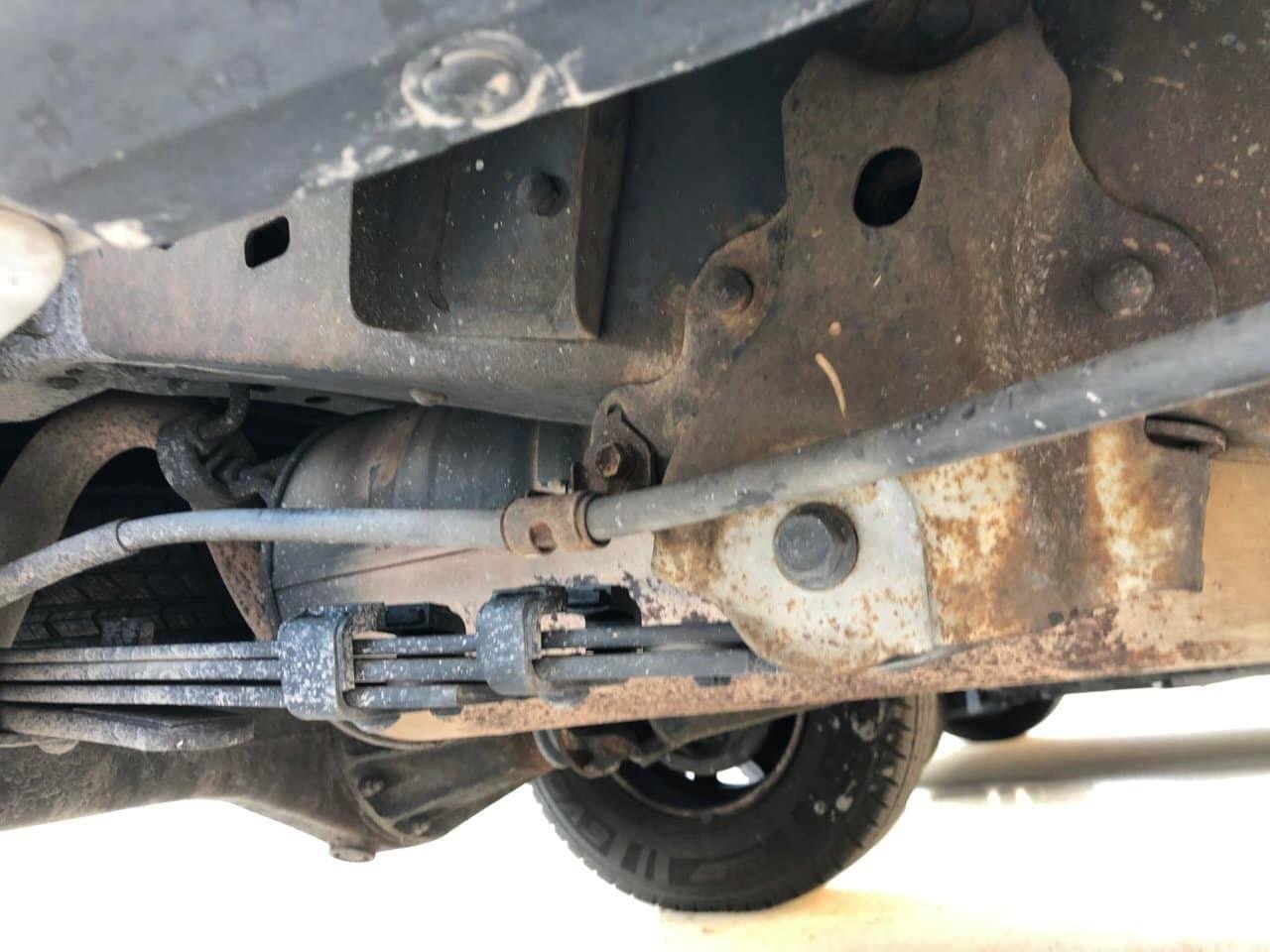

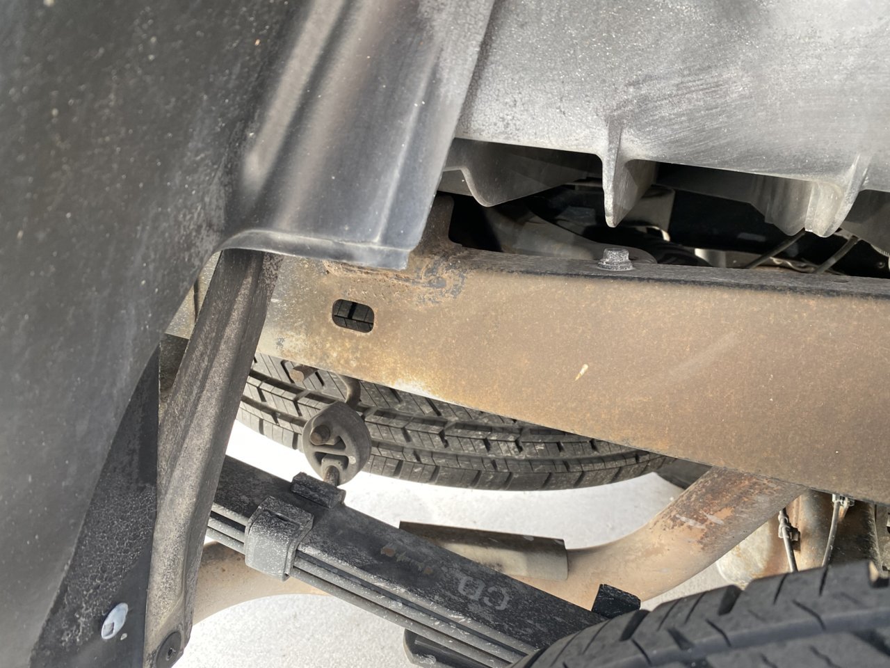

    I purchased and undercoating product, honestly don’t feel like sanding or doing major preparation to the chassis, its a Florida truck. Can I apply the undercoating straight on the chassis like it is? Please look at pictures.
    Thank you in advance.

    Please don’t use that rubberized undercoat, that’ll just trap moister and rust everything a lot faster. If you don’t live near the coast I wouldn’t do anything to the frame since you live in Florida. But it looks like the previous owner already sprayed some of the rubberized stuff on your frame already.
    I would just used fluid film then and spray it all inside the frame and out. Fluid film will actually creep underneath the rubberized stuff and it’ll eventually come off or make it easier to come off.
    Just YouTube “Rubberized undercoating will destroy your car” and you’ll see a bunch of videos on it.

    Thank you, honestly what I want is something to apply as-is, according the pictures i posted, don’t want to deal with surface preparation, I don’t have a lift. I am looking for something to apply that is better than applying nothing.

    No surface prep required for fluid film or similar products. In fact a light amount of surface rust helps it stick to the surface, and it will stop any active rust dead in its tracks.

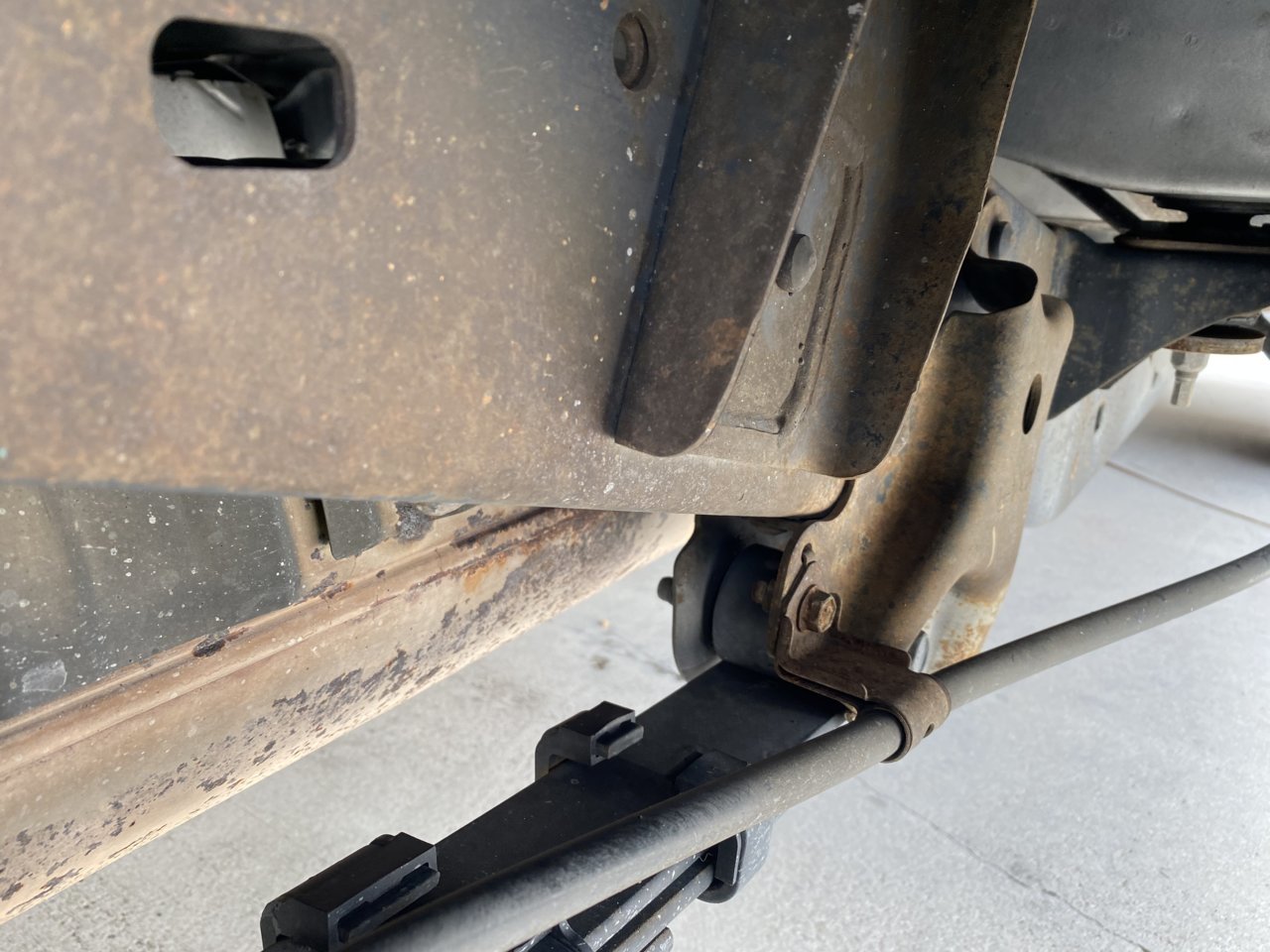

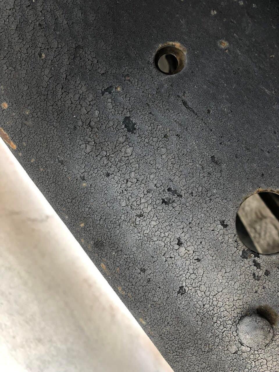

    Quick question, it has some areas if you look in the pictures it has some rubberized protection. Should it be removed with a wire brush? Is just applying the fluid film on top will be enough?

    You can just spray it right on that and it will work fine.
