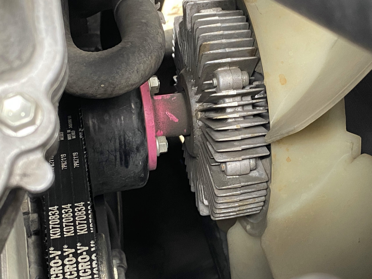

    Maybe a video of the truck showing the speedometer ?
    I would like to see what his clutch fan looks like

    Below is the fan clutch looks decent to me Im going to open the throttle body later to see if its dirty

    Next , grab the clutch fan while the truck is cold .Can you spin the clutch fan when its cold ?
