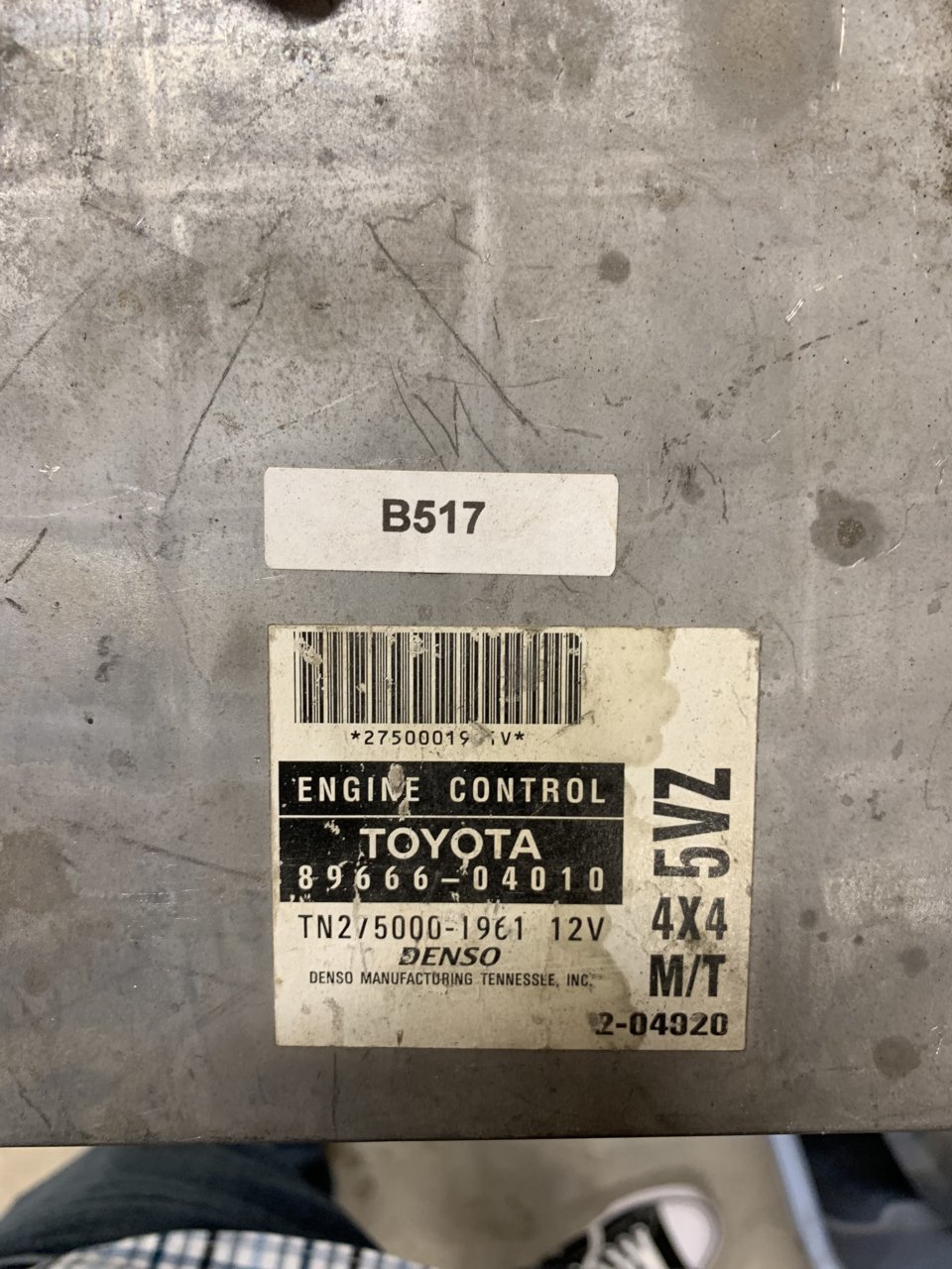

    Pueblo, CO
    5vz swap
    Will this one work?

    Maybe someone else will know, all I see is a circuit board.
